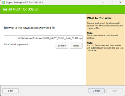

After downloading the package, return to the installer and continue with the local file selection step. Browse to the downloaded archive or toolbox package and click Install to continue. The installer accepts both .zip and .mltbx files.
Figure 13 - Browse to and download the S32K3 MBDT package from the Product Download page
