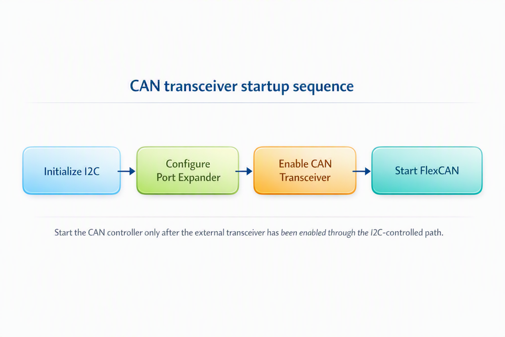

5.2 CAN Transceiver Initialization
One hardware-specific detail of the target board concerns the external CAN transceiver.
Note: Before CAN communication becomes available, the transceiver must first be switched from standby mode into normal operation. This transition is not controlled directly through a dedicated GPIO. Instead, it is performed through an I2C-connected port expander located on the board.
As a result, the startup sequence requires an I2C initialization step before the FlexCAN controller can begin communication.
Figure 3. CAN transceiver enable sequence on the target board.
