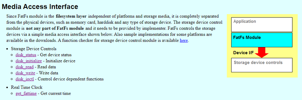

However, there is a lot to be written by your side in order to achieve the required functionality. I've never used this FatFS but I had a look over the documentation and basically you have to implement the following c code functions:
Basically the FatFS is a layer that represents the file system, but the physical layer, in our case SPI has to be implemented by yourself. In other words, you need to tell to the FATFS how to send data over SPI. You started well using our config block for setting up the SPI peripheral but you need to implement all the above functions in the diskio.c
If you have a look at the lpspi_master_driver.h file in our generated code you can see that you can send data using the LPSPI_DRV_MasterTransferBlocking blocking. You see there the implementation.
Luckily there are some samples projects there so you might find something interesting. http://www.elm-chan.org/fsw/ff/ffsample.zip
There is also a lighter version called petitFS. Even is for the 8bit processors, if you only want to store data, I think it might work.
