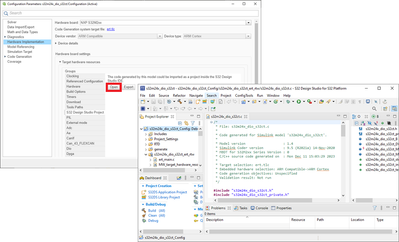

The toolbox automatically generates the <model_name>_Config folder, next to the Simulink model location, providing the user the opportunity to easily import the generated code from Simulink into S32 Design Studio. Each time the code is generated, the <model_name>_Config folder is updated with the new changes. The toolbox also provides a mechanism to launch an S32 Design Studio instance, with the imported generated code project in the Project Explorer tab from S32DS.

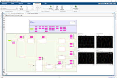

  • Simulation modes:
We provide support for the following simulation modes (each of them being useful for validation and verification):
    • Software-in-Loop (SIL)
    • Processor-in-Loop (PIL)
    • External mode

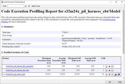

  • Support for profiling in PIL mode:

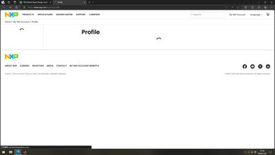

When I click the urls in this passage,I will always redirect to my personal page taht I can not go to the true urls.

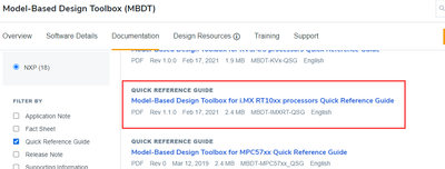

And I wonder is there a quick reference guide for s32m244 like this ?

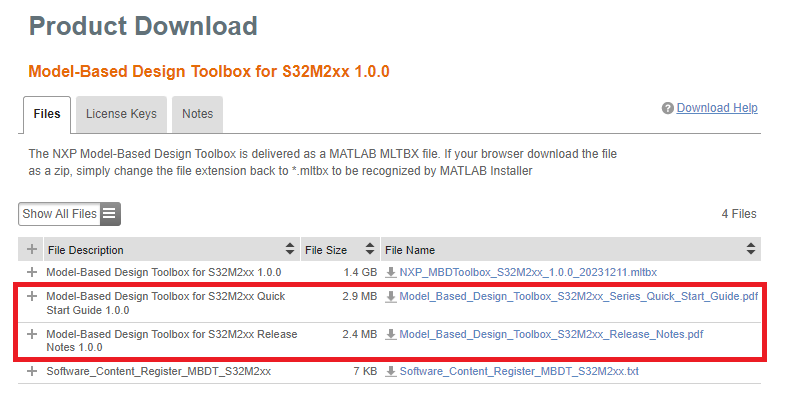

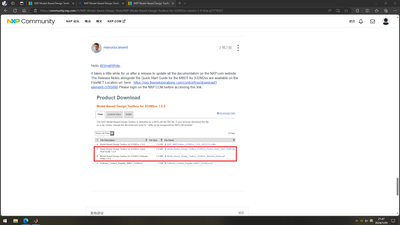

Hello @SmallWhite ,
It takes a little while for us after a release to update all the documentation on the NXP.com website. The Release Notes alongside the Quick Start Guide for the MBDT for S32M2xx are available on the FlexNET Location url: here:  https://nxp.flexnetoperations.com/control/frse/download?element=3785898 Please login on the NXP.COM before accessing this link.

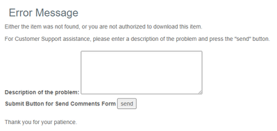

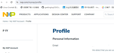

Hello, I have encountered the same problem. Clicking on this link https://nxp.flexnetoperations.com/control/frse/download?element=3785898 will still redirect me to the account information interface, and I cannot find the correct URL. Also, I have logged into my own account before that.
First,I click on this link:
Then,
The result is that the correct URL cannot be redirected.
And I still can't find the correct URL when I click on the link on this Matlab script.

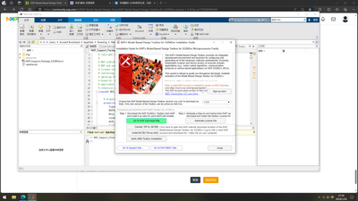

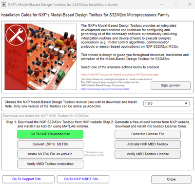

When I click on the following "Go to NXP Download Site" button:
It redirects me to the page below:
Can you provide a location that I can download the S32M2xx Model-Based Design Toolbox?
