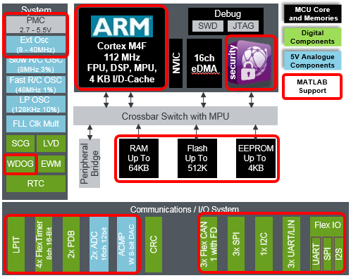

Main Features:
  • Embedded target support for S32K144 and S32K142 MCUs with example for S32K144EVB-Q100 and S32K142EVB-Q100 evaluation boards

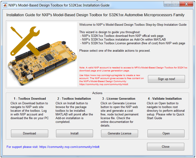

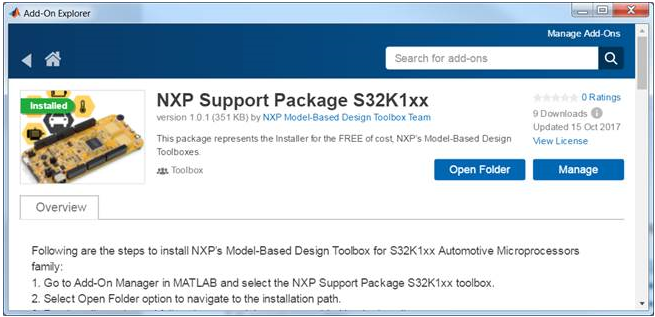

  • Online installer available directly from MathWorks website Add-On Explorer.
Installation Guide step-by-step application to provide an improved user experience for toolbox download, installation and license generation from NXP websitepastedImage_8.png

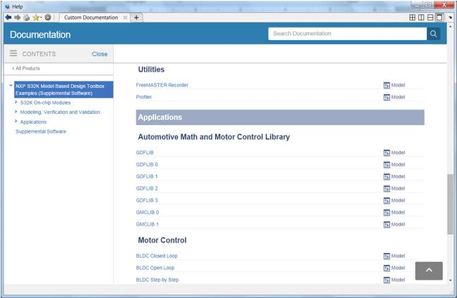

  • Documentation, help and S32K1xx examples fully integrated into MATLAB development environment for ease of use and fast prototyping
  • New peripherals support for:
    • Watchdog (WDOG)
    • Power Management Controller (PMC)
    • Low Power Timer (LPTMR)
    • Cryptographic Services Engine (CSEC)
    • FlexIO for supporting I2C, SPI and UART communications
  • Add new functionalities for:
    • CAN with Flexible Data Rate (CAN-FD)
    • CAN with Rx FIFO
    • CAN Pretended Networking
    • Blocking or Non-Blocking transmit/receive modes for Communication blocks
    • FreeMASTER configuration block for embedded driver
    • Support for SRAM application download
  • Enhance the support for all existing Simulink blocks to support basic and advanced mode of peripheral configuration
  • Support for MATLAB 2017b release
  • Integrates the Automotive Math and Motor Control Library release 1.1.9 for ARM M4 cores
  • Integrates the SDK release version 0.8.4 EAR for S32K1xx MCU. NXP’s Model-Based Design Toolbox generates codes based on standard SDK API, covering most of the functionalities exposed by SDK
