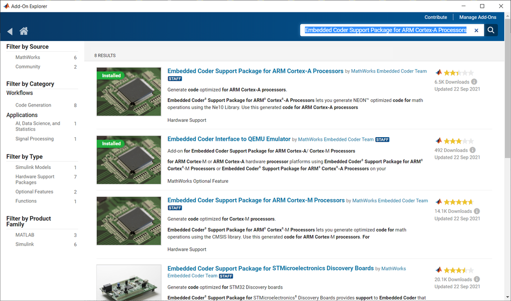

3.1 Mathworks MATLAB and Add-Ons
Install the following software from Mathworks required to build and run any model that uses the NXP Model-Based Design Toolbox for HCP :
Install the following additional toolboxes from Mathworks required to build and run the HEV demo:
All these toolboxes can be installed from MATLAB, by opening Get Add-Ons window and searching for each of these toolboxes.

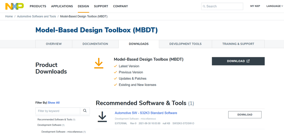

1. Go to nxp.com and sign in to your NXP account.
If you don't have an NXP account, create one from the Registration page. Toolbox is for free but an account is required to download the tool and access training & support on NXP Model-Based Design Toolbox Community).

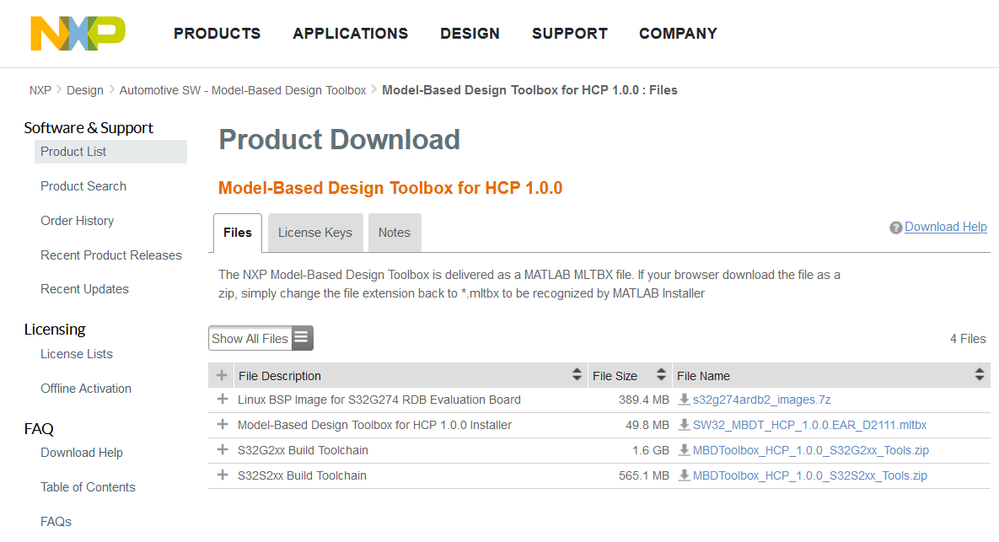

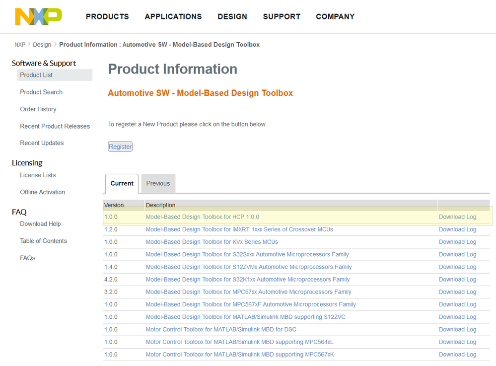

2. Go to NXP Model-Based Design Toolbox (MBDT) page, select the DOWNLOADS tab and press the Download page, which will open the Model-Based Design Toolbox download page.
3. From the Model-Based Design Toolbox download page select the Model-Based Design Toolbox for HCP 1.0.0, and then on the next page, you will be asked if you agree to the Software Terms and Conditions.
4. On the Model-Based Design Toolbox for HCP download page, download the following files:
  • SW32_MBDT_HCP_1.0.0_EAR_D2111.mltbx, the toolbox installer
  • MBDToolbox_HCP_1.0.0_S32S2xx_Tools.zip, the S32G2xx build toolchain
Some browsers will download the .mltbx file as .zip file.  To avoid that, please press right click on the download link and select Save link as.

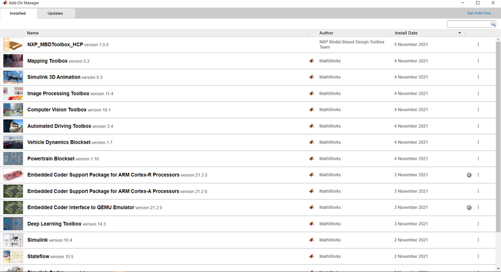

5.  Open MATLAB, navigate to where you downloaded the toolbox installer, and run the installer (press double click or right-click and select Install).
6. After a few minutes (~4-5min), the NXP’s Model-Based Design Toolbox should be visible as a new add-on in the Add-On Manager.

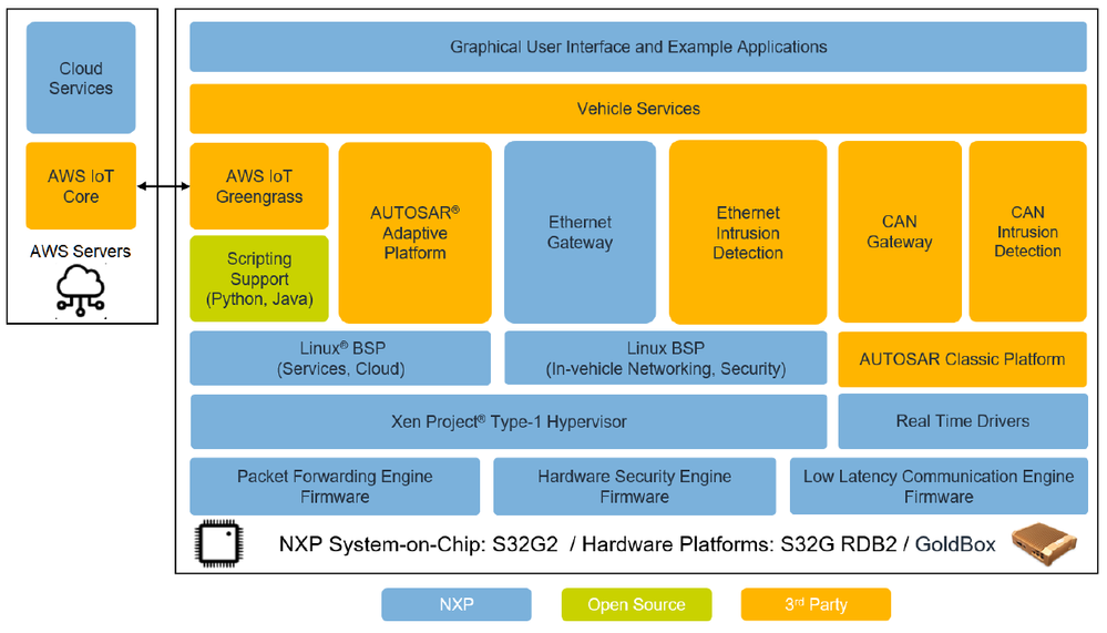

The GoldVIP is a reference software platform for a vehicle service-oriented gateway running on NXP vehicle network processors like the S32G274A.
Following figure shows the GoldVIP high-level architecture.

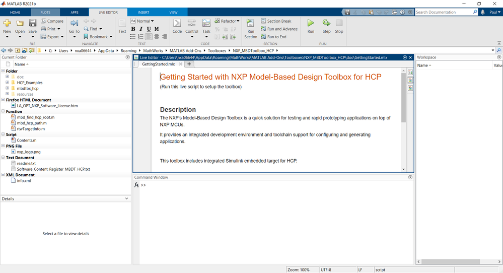

NXP Model-Based Design Toolbox for HCP offers a Setup GUI to select which toolchain to use, flash the Linux image card, configure and test the network connection.
After the installation of the toolbox has finished the GettingStarted.mlx file is opened.
To run it go to the LIVE EDITOR tab and push the Run button. Running it will open the Setup GUI that will help you configure the toolbox.

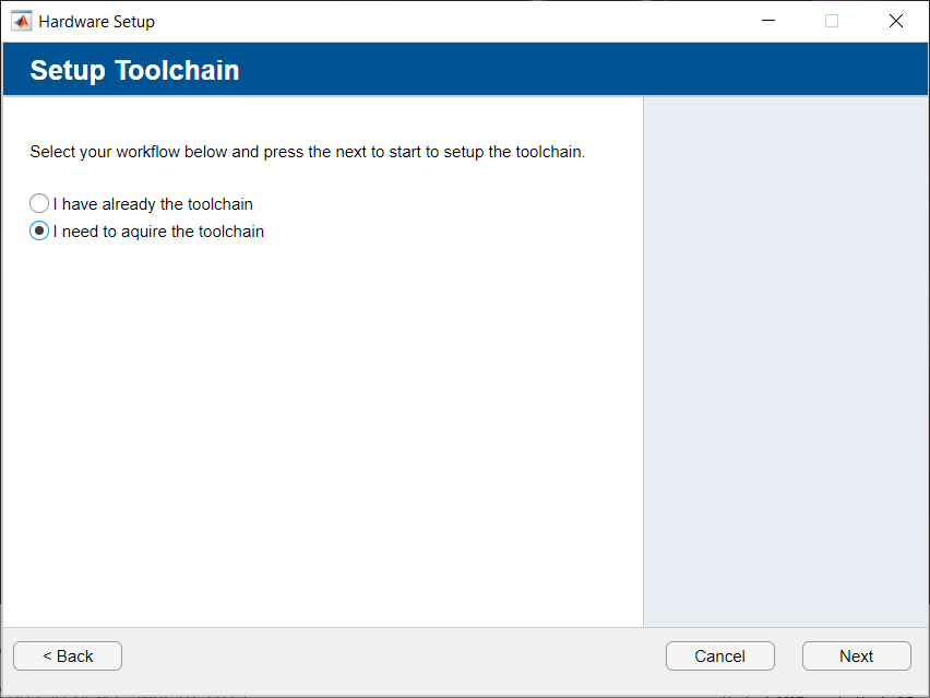

5.2 Setup Toolchain
Select I need to acquire the toolchain and push the Next button. In case you already have the toolchain the steps are a subset of the one below.

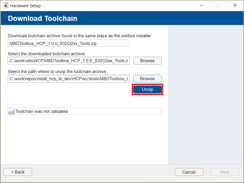

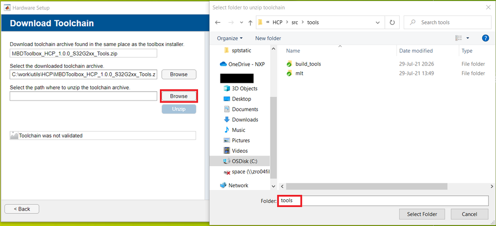

5.3 Download Toolchain
Next download the S32G2xx toolchain by following the steps from 3.2, step 4, if you haven't already done so, and then select the path to the downloaded toolchain archive.
Then select the folder to where the archive should be unzipped.
Next press the Unzip button to unzip the selected toolchain archive. This step will take around 10 minutes.
If the toolchain archive is unzipped successfully, the Next button is enabled.

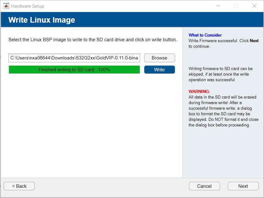

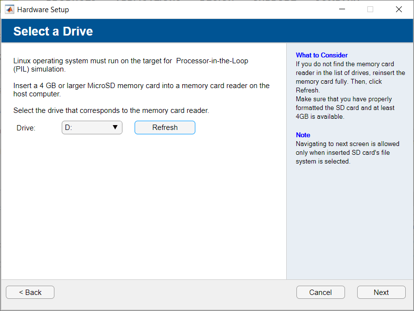

5.5 Write Linux on the microSD card

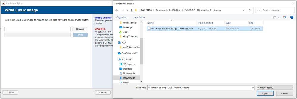

This page helps you to write the Linux on a microSD card. First, insert the microSD card, then push the Refresh button to actualize the drive list. If the microSD is available in Windows the list should be not empty. Select a drive from the list and push the Next button.
Select the Linux image using the Browse button.
Finally, push the Write button to write the Linux image.

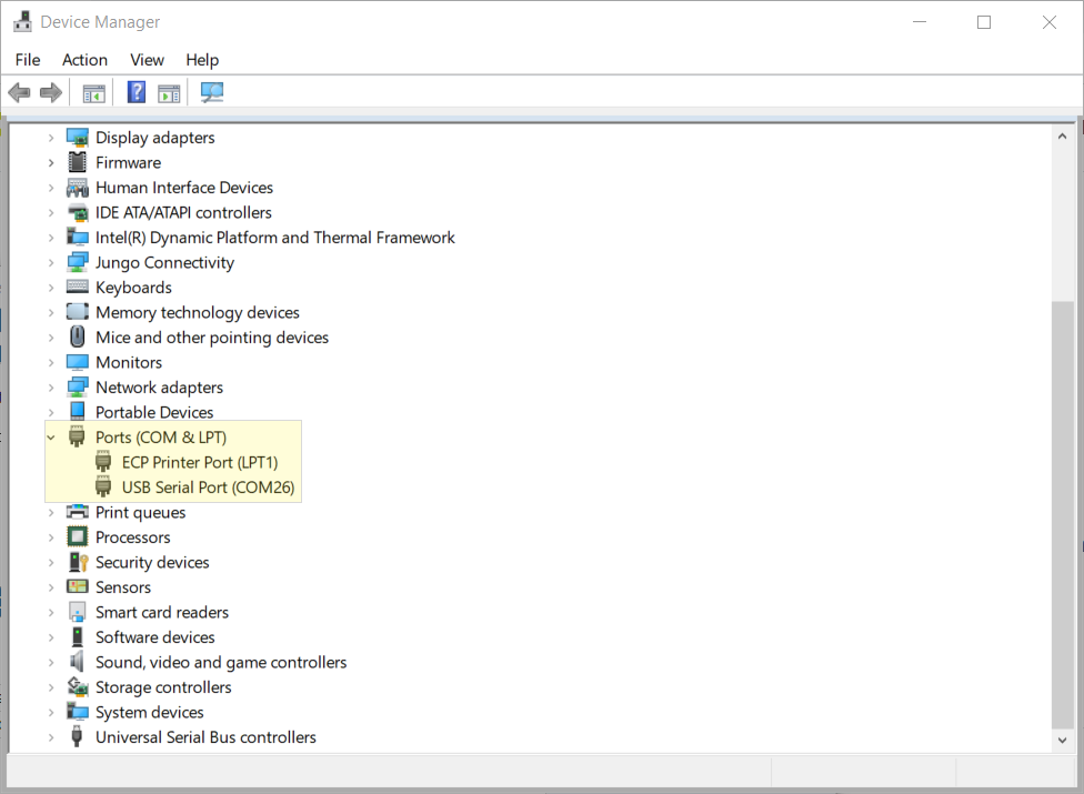

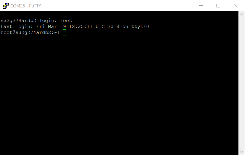

5. Open the terminal emulator (e.g. putty) to connect to the board and configure the network settings.
Select the serial port added to Ports (COM & LPT) in Device Manager when the micro USB cable is connect to the host machine, and select 115200 as the baud rate.
If you didn't install the FTDI driver in the previous steps, a new COM port will not be added when you connect the USB cable.
Once you connect over the serial to the board, you will be asked to log into Linux in the terminal emulator. The default username is root, without a password.
If your network assigns IP address automatically via DHCP, you don't need to do any network configuration on Linux. Otherwise, you will have to configure the network settings for pfe2 interface.
Run ifconfig pfe2 to get the IP address that we'll use for PIL simulation. The field that we are looking for is inet, and in the bellow output the IP address is 192.168.2.152.

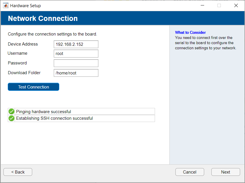

5.8. Setup network connection
Fill in the Device Address, Username, Password, and Download folder, and then push the Test Connection button. This tests if the device address is valid, and also if the a SSH commands can be run.
For the Device Address use the IP address copied from the output of ifconfig pte2. Default username is root, and no password is set. Default download folder is the home folder of the root use, /home/root.

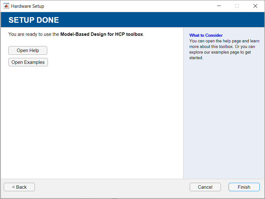

5.9. Setup done
Congratulations! You are ready to use the Model-Based Design for HCP toolbox.
Note: Press the Finish button to save the toolchain path and network connection settings.

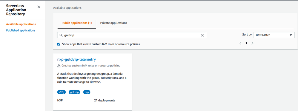

1. Go to the AWS SAR console: https://console.aws.amazon.com/serverlessrepo/
2. Go to Available applications tab; then to Public applications and search for goldvip.
3. Check Show apps that create custom IAM roles or resource policies to see the application.
4. Click on nxp-goldvip-telemetry. You can modify the application parameters.
5. Check I acknowledge that this app creates custom IAM roles.
6. Click Deploy. The deployment will take a few minutes. You will be redirected to another page.

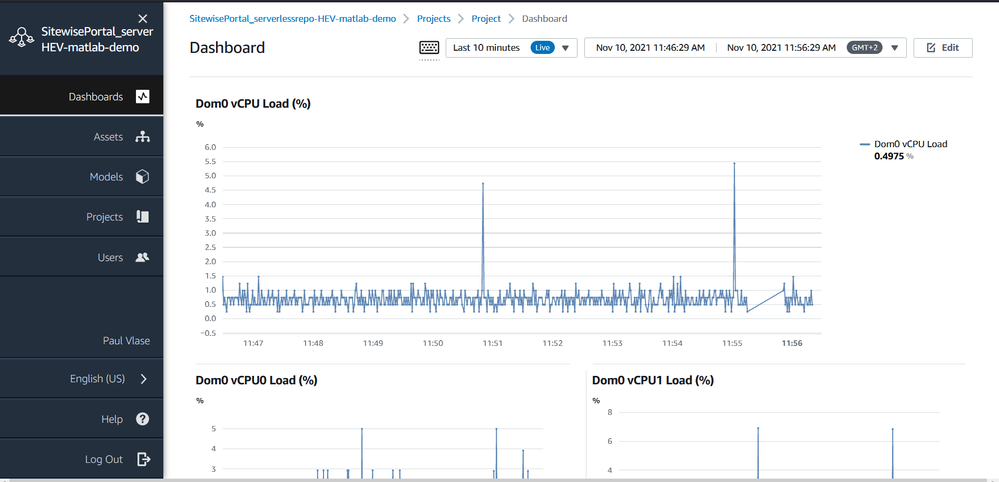

This CloudFormation stack creates on your account:
  • A Greengrass V2 telemetry component, this is a python function which runs on v2xdomu and sends data to AWS IoT Core. The provisioning script described in chapter 7.4. Connecting the board to AWS creates a Greengrass V2 continuous deployment which will run the telemetry component on your board.
  • A SiteWise Portal with multiple Dashboards; after the board is connected to AWS a live visual representation of the telemetry data received via the Greengrass V2 component is displayed in these.

7.6. Accessing the SiteWise dashboard
1. Go to the SiteWise console: https://console.aws.amazon.com/iotsitewise/
2. Click on Portals from the list on the left.
3. Click on the name of your portal, it starts with SitewisePortal_serverlessrepo.
4. Click on Assign administrators.
5. Add your account and any other you want to have access to the SiteWise Dashboard.
6. Click Assign administrators.
7. Click on the Portal’s Url (or Link).
8. Close the Getting started pop up window.
9. Click on one of the dashboards to visualize the telemetry.
You will now see the live telemetry data from your board.
For more information check the GoldVIP User Manual.

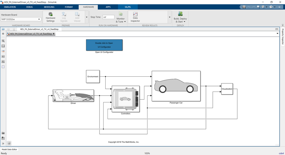

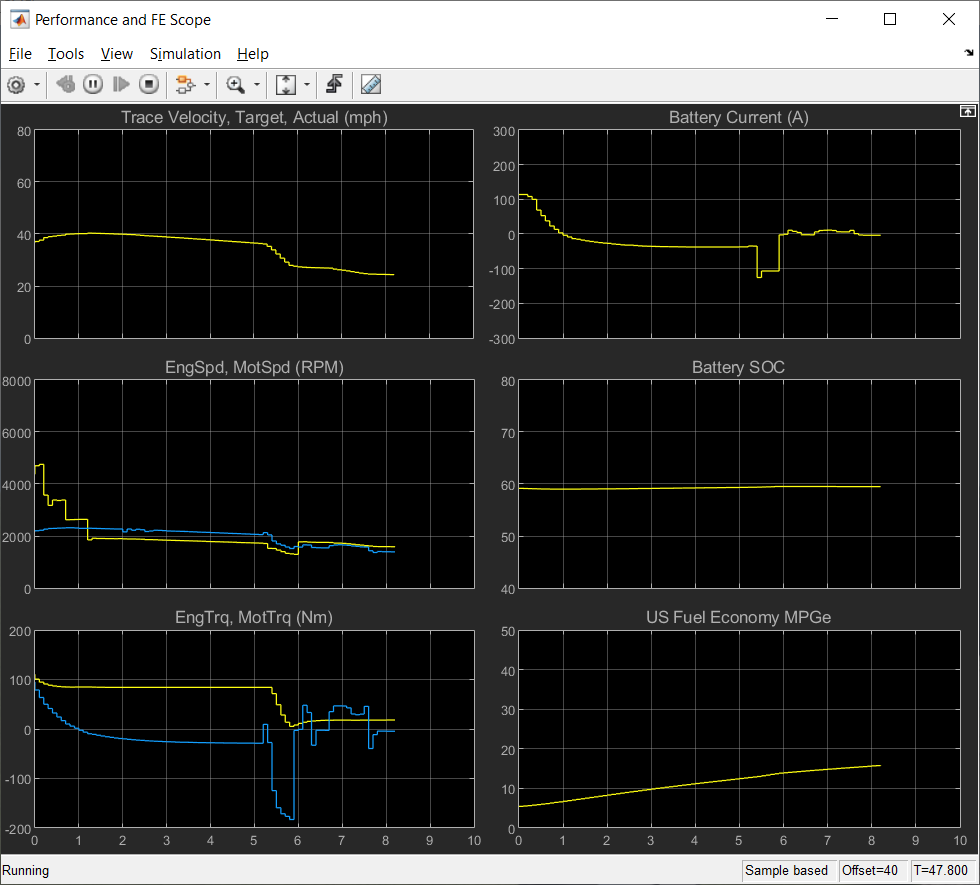

8. Running HEV demo
1. A Logitech F310 gamepad is needed to control the car. Connect the gamepad before opening the model.
2. We recommend to make a copy of the HEV demo folder from HCP toolbox in another working folder.
Run the following command in Matlab to navigate to S32G2xx examples folder.
cd(fullfile(mbd_find_hcp_root(), 'HCP_Examples', 's32g2')
Copy the HEV_P4_Ext_TV to another working folder, e.g. C:\workspace\.
3. Open the HEV_P4_ExternalDriver_v3_TV_v4_fixedStep.slx model.
The HEV demo is already configured for PIL simulation mode.
3. Run the PIL simulation by pressing the Start button from . Simulink generates the code for the model, compiles it, downloads it on the board, and then starts the simulation.
