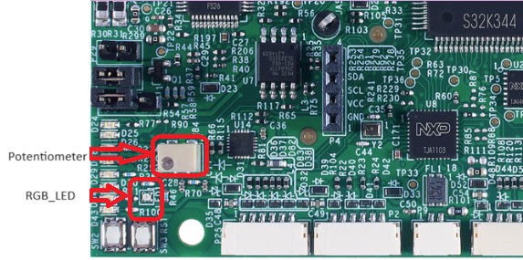

2.1 Hardware Connections

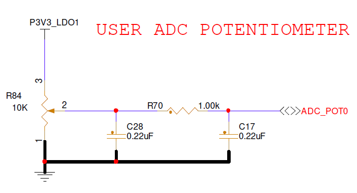

The MR-CANHUBK344 evaluation board has multiple ADC channels that can be routed on various pins in complex applications. Our focus will be on the ADC channel corresponding to the potentiometer.
The potentiometer present on the board (R84) is a 10K trimmer potentiometer connected between 3V3 and GND and is connected to the net named ADC_POT0. This is further routed via pin 11 – PTE13/ADC1_S19.
  • Potentiometer  and LED1 placement on the EVB:

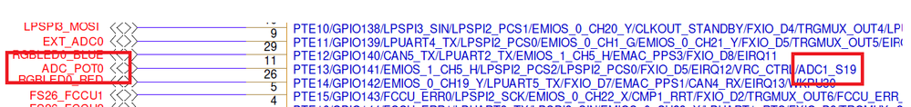

 Potentiometer schematic:
 ADC_POT0 pin and its different routing options, with the correct one highlighted can be seen below:

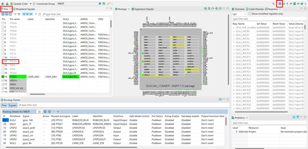

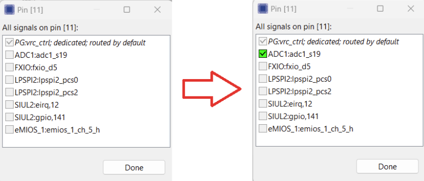

2.2 Pins Configuration

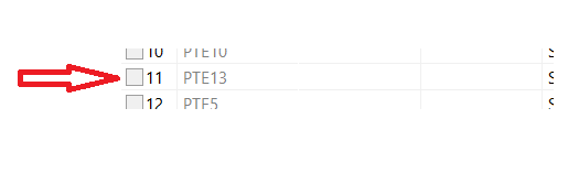

Firstly, we need to specify the configuration options for the pin itself. This is done in the Pins menu of the S32 Configuration Tools, as follows:
 1.We search for the PTE13 pin and check if it is already configured.
In this case it is not routed to any functionality, but, if it was routed to anything but ADC, we need to perform the same steps:
1.Click on the checkbox near the pin name:
2. Select ADC1:adc1_s19 from the pop-up window:
 3.Provide a label and identifier for the newly mapped pin
In this example, the Label and Identifier are set to ADC_POT0
After the pin is configured, we move to the Routing Details menu:
FlorinCiuca_7-1698395097527.pngWe search in the Routing Details menu for our pin, using the label set at the previous step. Once we find our pin, we check for the following options to be configured as follows:
  • Direction to be configured as Input
  • Input Buffer Enable to be configured as Enabled and update them accordingly if they aren’t.

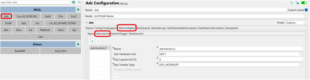

With the pins properly configured, we can move on to configure the Adc peripheral. We open the Adc component and begin by navigating to the AdcConfigSet tab where several steps need to be performed. In the AdcHwUnit menu, we first need to define a HW Unit for the ADC.  If no HW unit is defined, a new one can be created by clicking the "+" button. We can modify the default configuration delivered with the toolbox and automatically assigned by MBDT in the new Simulink model or we can configure a new one. With the ADC peripheral instance defined, the first steps are to:
Name our HW unit. In this example it is named AdcHwUnit_0.
Select the ADC hardware of our unit. As we already know from the schematics, the potentiometer uses channel S19 of the ADC1, so we choose ADC1 for this configuration option.
The logical Unit ID is used to enumerate multiple HW units if present. Since for this example we only have one, we put the value 0 here.
For the transfer type we can choose between either Interrupt or DMA. For this example, we choose to use interrupts.
From the options presented below, most of them are not relevant for this example and can be kept with their defaults value.
An important setting is the conversion resolution. For this example, we chose the maximum resolution of 14, which corresponds to a maximum value of 2^14 (16384).

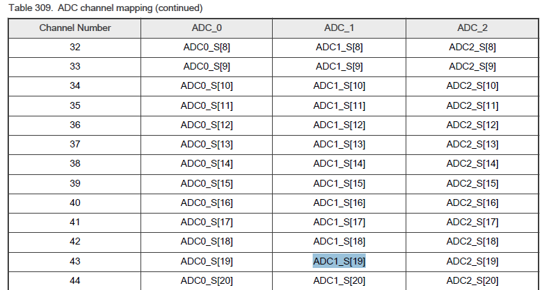

For the Physical Channel Name, we choose S19_ChanNum43 because we know we are on the S19 channel of the ADC. By looking in the S32Kxx Reference Manual we see that channel number 43 is mapped to ADC1_S19.
Physical Channel Id is just a mirror of the channel number from point 3.

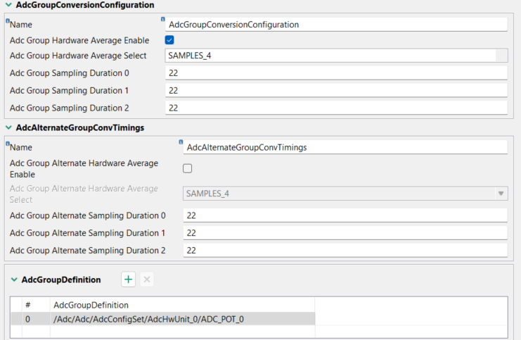

We can configure several options for conversion as well. In this example we have HW average enabled, using 4 samples. This is done in order to mitigate noise that may occur on the readings without delaying too much the final results.
In the AdcGroupDefinition menu, we have to add our channel, as configured in the previous steps.

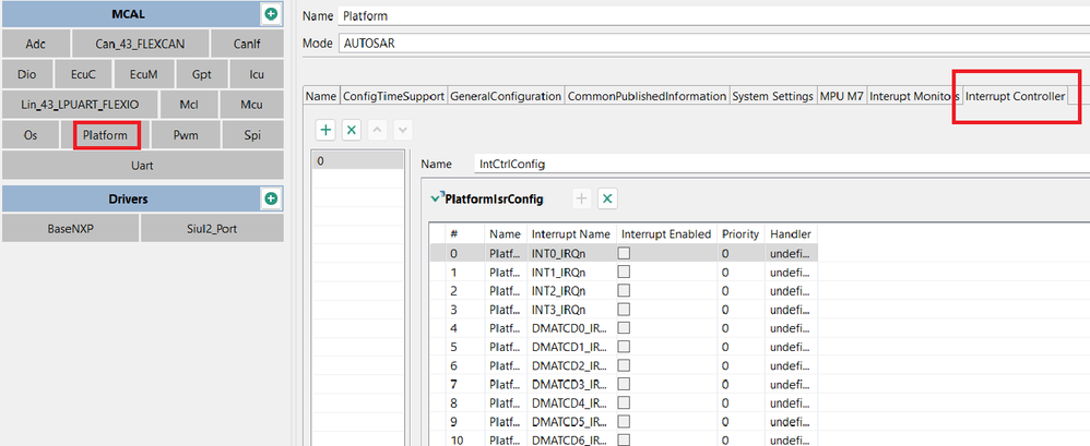

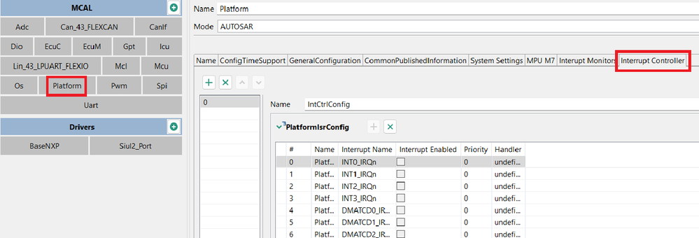

2.5 Interrupts Configuration (Platform)
Since we opted to use the ADC in Interrupt Mode, we need to perform the correct configuration options inside Platform MCAL component.
The corresponding Interrupt Vector needs to be enabled, a priority must be given to it, and the correct handler function has to be specified from the RTD implementation.
All these options are configured inside Platform peripheral -> Interrupt Controller tab:
 As it can be observed, the Interrupt Vector for ADC1 is enabled, has a priority of 5 and its handler function is Adc_Sar_1_Isr.

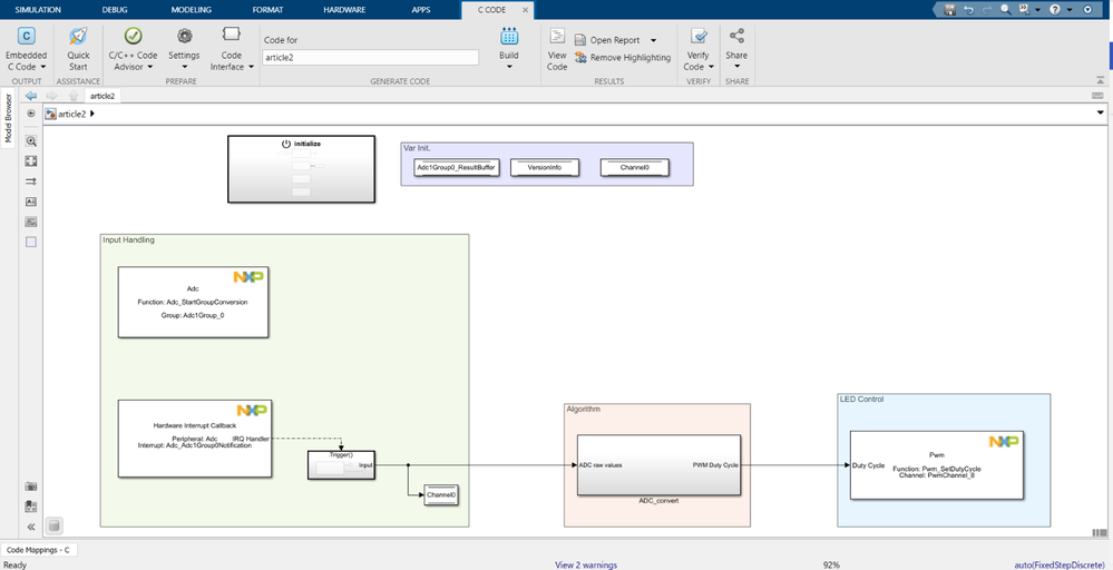

 3. ADC Model Overview
 With the configuration in place, the usage of S32 Configuration Tools (S32CT) is finished and we can implement our application in Simulink. In the following sections, we will go through the steps of creating a model that reads the potentiometer voltage and displays its value, converted into digital values, in FreeMASTER. More details FreeMASTER setup can be found in article 2.

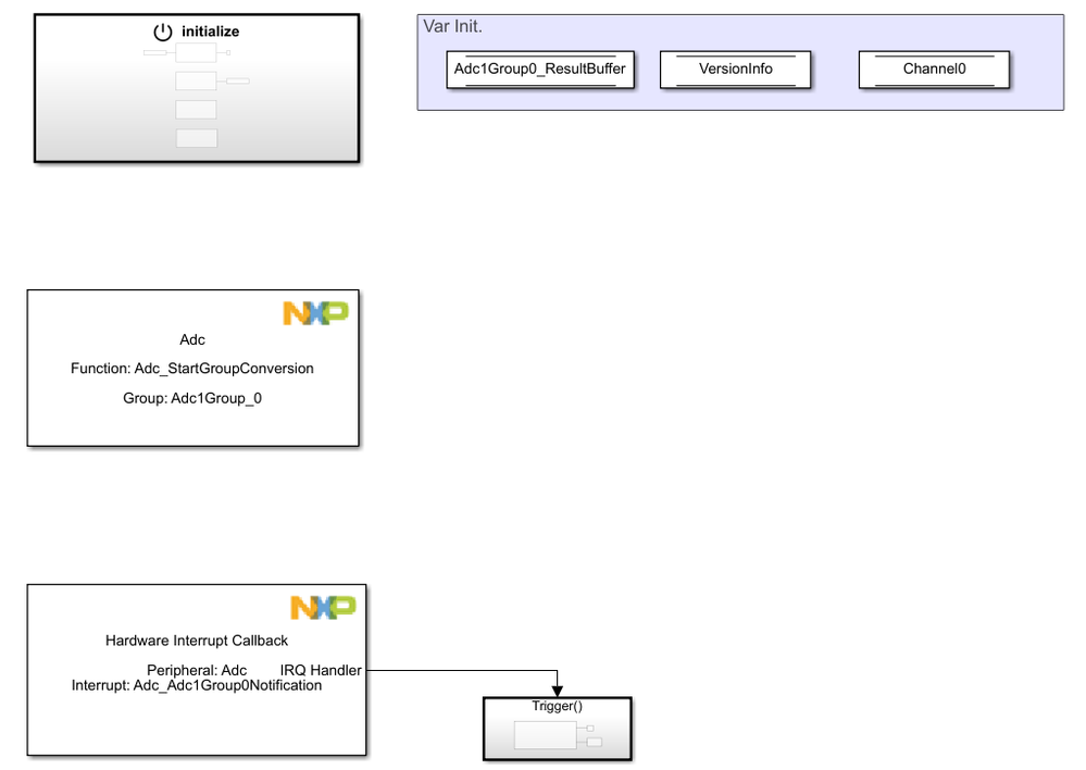

Model overview:
 Going from top to bottom we have:
  • 3 data store variables: the ADC VersionInfo, Adc1Group0_ResultBuffer, and Channel0.
  • The initialize block
  • The FreeMASTER config block
  • The Start Group Conversion block
  • The HW Interrupt Callback block, which triggers:

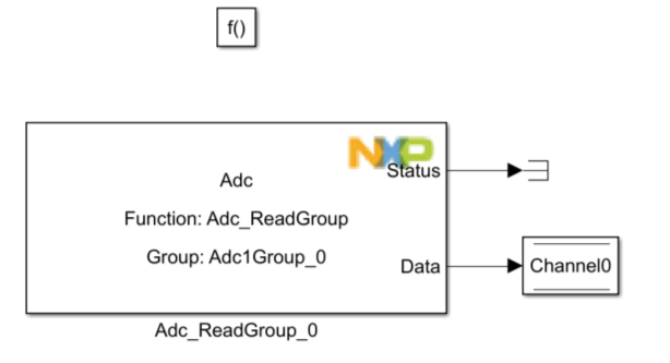

  • The ADC Read Group block

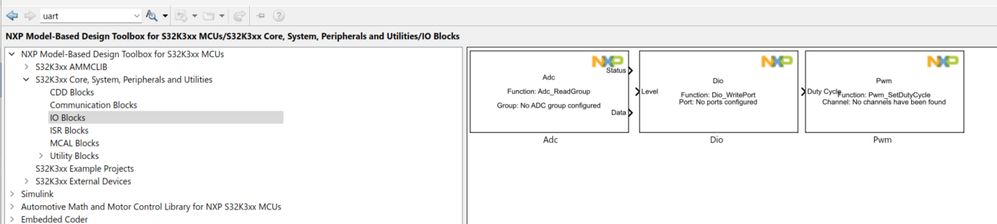

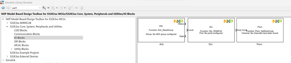

All the ADC blocks can be found inside the MBDT:
The functionality is further detailed below:
In the initialization block we prepare the SW for the ADC conversion by assigning the result buffer variable for our ADC group and by enabling the Group Notification.
Note: To be observed that the ADC Group used in both ADC blocks is exactly the same as the one underlined in 2.3 configuration chapter.
With the initialization done, the ADC group conversion can be started. This is performed periodically in the model’s step() function.
When the group conversion is finished, the group notification callback signals back to us that we can read the ADC value, and this is done into the subsystem triggered by the Hardware Interrupt block:
FlorinCiuca_25-1698395097540.pngThe freshly converted value is stored inside Channel0 variable and it is ready to be used further.

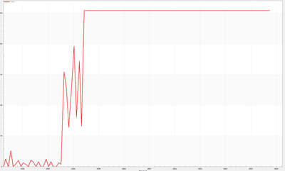

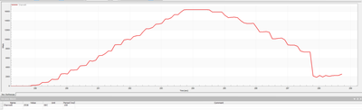

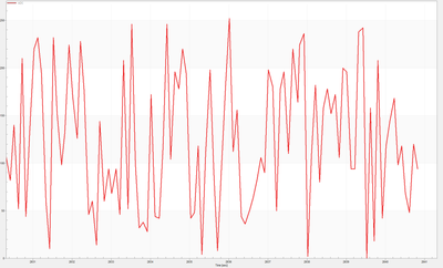

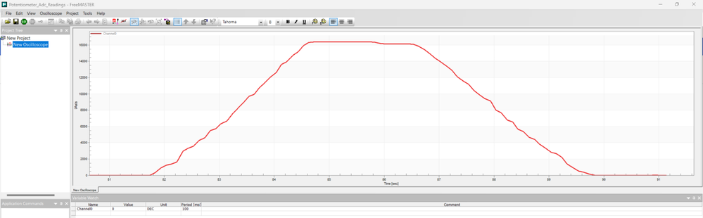

As it was observed in Sending data via UART and monitoring signals with FreeMASTER, FreeMASTER can be used to observe the evolution of a certain variable over time. We can use this feature to display the ADC readings stored on Channel0 on an oscilloscope.
We check if the values shown match our expectations when the Potentiometer is rotated. As it can be observed in the picture below, the values go from 0, up to 16384, and then back down to 0, as the potentiometer is rotated clockwise and then counterclockwise. This fully matches our expectations and validates that both the configuration and the Simulink application are implemented correctly.

The MR-CANHUBK344 is suited for various Pulse Width Modulation applications. The main PWM output port of the board is P8A, which in conjunction with P8B can be used to control and read feedback from common servomotors.
In this example , we are controlling the intensity of the RGB LED via PWM, based on the ADC readings from the potentiometer.
Note: The PWM control of the RGB LED is possible because each one of the 3 colored LEDs can also be routed via an eMIOS channel:

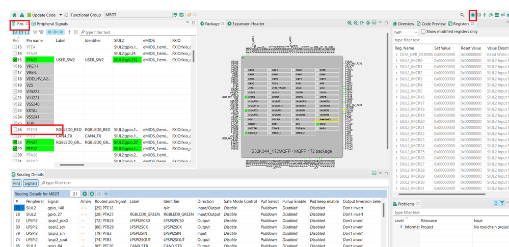

 4.2 Pins Configuration
Firstly, we need to route the pin:
We look for the port and pin number of the red LED, and we observe it is part of Port E and has pin number 14:

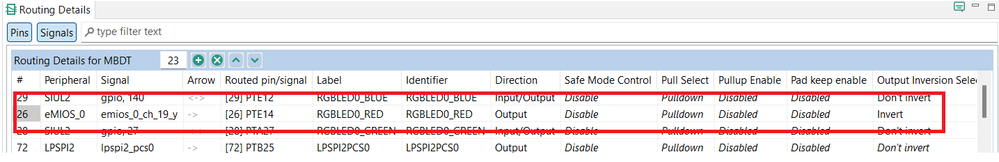

As we did for the ADC pin, we look for PTE14 inside Pins tool , and we route it to eMIOS_0: emios_0_ch_19_y
When prompted, we select Output as direction for our pin. We provide a label and an identifier(RGBLED0_RED) for the pin.
In the Routing Details menu, we should have the following options configured:
Direction: Output; Output Inversion Select: Invert and OutputBuffer Enable: Enabled.

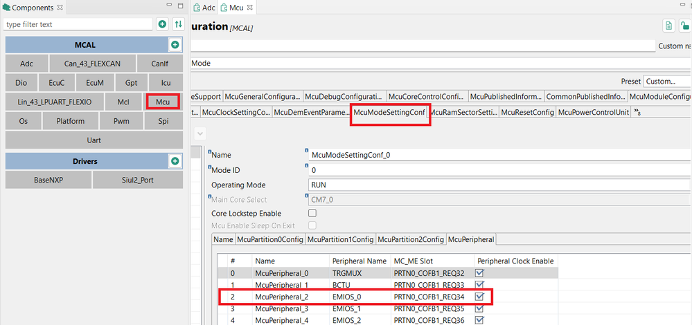

4.3 Clocks Configuration (MCU)

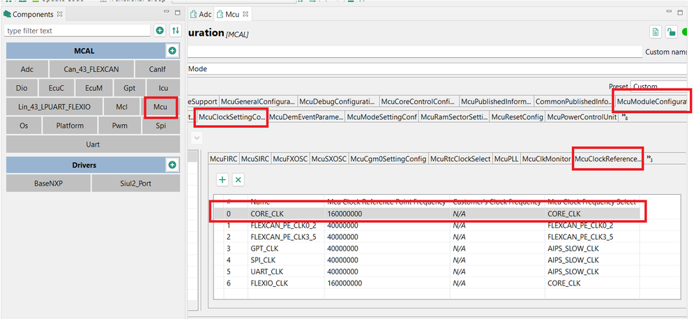

As a prerequisite, we need to make sure that CORE_CLK is configured . This can be observed inside Mcu component -> McuModuleConfiguration tab -> McuClockSettingConfig menu -> McuClockReferencePoint submenu
Moreover, we need to make sure that the clock is enabled for the eMIOS instance we will be using:
FlorinCiuca_34-1698395097545.pngThis can be done in Mcu -> McuModuleConfiguraion ->McuModeSettingConf - >McuPeripheral

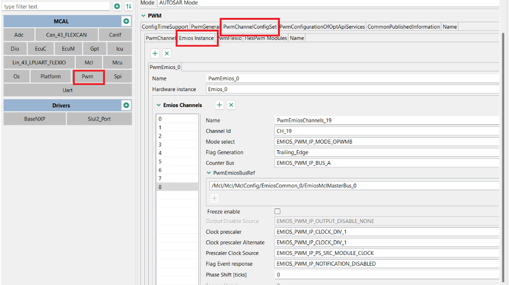

First of all, we need to add our eMIOS instance. This is done by clicking the "+" button at the top of the window. We need to make sure the proper hardware instance is selected, in our case, eMIOS_0.
With that in place, we can move to the configuration of the channels. If no channels are configured, a new one can be added using the "+" button. In our example, several channels are already configured, but our focus is on the 8th channel. With it selected, we set its name, we select the Channel ID to address  19th eMIOSchannel, select the desired operating mode(OPWMB), choose Bus A as a counter bus. For the PwmEmiosBusRef, we use the one previously configured at step 4.4.
We keep the prescalers at DIV_1 and we choose not to phase shift our signal, since it is not needed for our application.

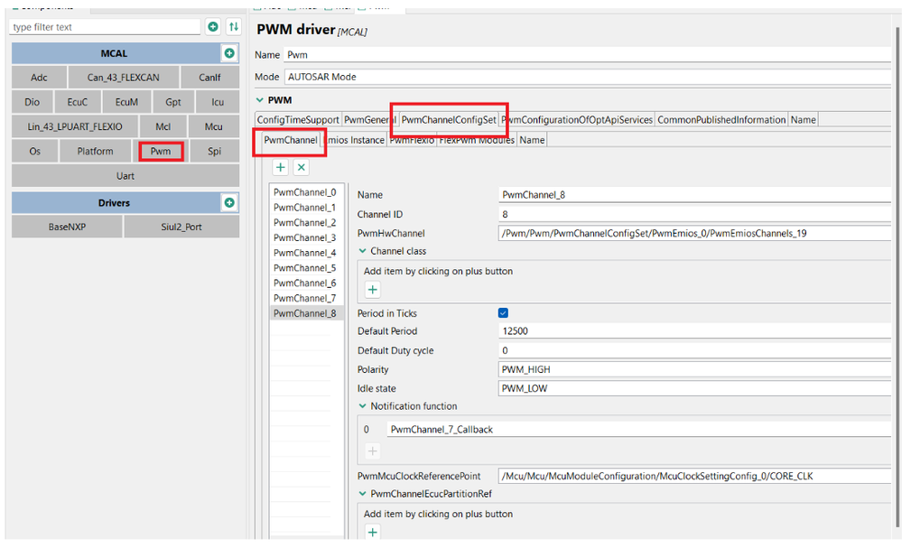

4.5.2 Pwm Channel
With the eMIOS channel configured, we can move to the PWM channel configuration.

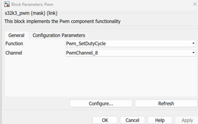

We add our channel, we give it a relevant name and assign it a channel ID. The Channel ID identifies the position of the channel in the configured list of channels.
For the PwmHwChannel option, we select the eMIOS channel configured at the previous step.
Default Period should have the same value as the one we defined for the Master Bus inside Mcl component, otherwise we will receive an error message.
Default Duty cycle represents the duty cycle forwarded to the LED at initialization. We keep it at 0 for our example.
At the PwmMcuClockReferencePoint option, we select CORE_CLK, as defined in the Mcu component.

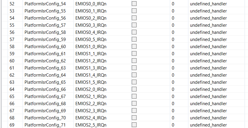

Note: For this example, the use of interrupts was not needed. However, if interrupts have to be used, proper configuration settings must be done inside Platform component:
FlorinCiuca_41-1698395097550.pngAs it can be observed, we have 6 Interrupt vectors, numbered from 0 to 5, for each EMIOS instance. Each vector handles 4 channels. The channels are assigned in descending order, starting with vector 0: For each instance, the _0 vector will serve the channels # 23, 22, 21 and 20, the _1 vector will serve the channels # 19, 18, 17 and 16 and so forth until the _5 vector which will serve the channels # 3, 2, 1 and 0.
This concludes the configuration part of the PWM channel needed for our example and we can move on with the Simulink model.

In order to implement this application, we will extend the ADC model created at step 3. Since we want to control the intensity of the LED based on the readings from the potentiometer, we will use the ADC converted potentiometer value as an input for the PWM channel.
 Our application is structured into 4 parts:
  1. Initialization part
  2. Input Handling
  3. Algorithm
  4. Output Setting
The Initialization and Input handling sections of our application are similar to the ones present in the model created at step 3 of this article, the only exception being that the ADC reading is not only stored inside Channel0 variable, but it is also fed into the algorithm.

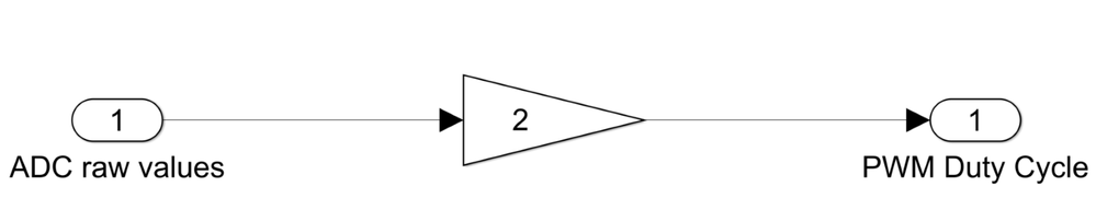

Our application’s algorithm’s goal is to convert the raw values provided by the ADC into values that are accepted by the PWM block. Since our input values need to be scaled up with a factor of 2, we need to apply the Gain block from Simulink.
We need to consider that the Pwm Block expects an argument of uint16 data type, so we need to make sure that the gain applied is of that type:
The output of our application is represented by the LED intensity (i.e. the duty cycle). One important mention here is that the duty cycle is not expressed as a percentage, but as a value from 0 to 32768 (0 -> 0% duty; 16384 -> 50% duty; 32768 -> 100% duty).
For the output control, we need to use a Pwm block from the MBDT:
We drag and drop the Pwm block into our canvas, we select the desired function (Pwm_SetDutyCycle) in our case, and also the Pwm channel we want to control(we choose the PWM channel configured at 4.5.2 step, in our case PwmChannel_8; all the channels selectable from the drop-down list are the ones previously configured in S32CT) :
We apply the algorithm to the input value and feed the result into the PWM block:
 Below, a video showcasing the functionality can be found
In the first part of the video, the potentiometer is rotated clockwise and the duty cycle of the LED gradually reaches 100%, then, in the second half of the video, the potentiometer is rotated in the opposite direction and the LED can be observed dimming down until it turns back off completely.
Note: The status LEDs were covered with black tape so that the Red LED's intensity can be seen more clearly

I want to use EXT_ADC1 on PTE0 to drive the LED intensity based on Input voltage on the PIN (6 of P8B).
I have configured the PTE0, however, I observe that the ADC read value is stable only when the PIN is set to ground or when the pin is set to VCC. For all other variations in the voltage the ADC read value keeps on oscillating.
Oscilloscope when Pin is connected to Ground
Oscilloscope when Pin is connected to VCC
Oscilloscope when Pin is connected to 1V
How do I read the voltage steadily on the PIN ? Thanks
-Ankit
Hello Ankit!
I modified the example provided in the article to read the voltage on EXT_ADC1 Pin instead of POT0 and it seems everything is working as expected.
Apart from routing the PTE0 Pin, it is also required to modify the ADC Channel from Adc Peripheral(from ADC1_S19 ChanNum43 to ADC1_P2 ChanNum2).
I am attaching the updated configuration file, so that you are able to make a comparison and see what is missing.
Note: With the updated configuration and the rest of the example unchanged, the LED intensity should vary based on the voltage applied to P8B Pin6 instead of the Potentiometer readings.
I hope this explanation was helpful.
