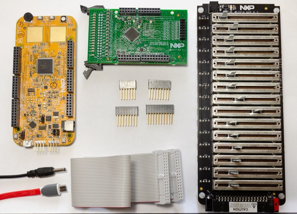

 2.1.1 MC33771BSPI (7 up to 14 cells battery pack) Setup
  1. S32K144EVB
  2. FRDM33771BSPIEVB + connectors
  3. BATT-14EMULATIOR + ribbon cable
  4. microUSB cable (for S32k) + 12V power supply (for Battery emulator)
Before going to the next step, the solder jumpers for the FRDM33771BSPIEVB board must be configured in order to make it compatible with the S32K144EVB. This process is detailed both in the UM1143 [4.1] Table 1 or  User-Guide [4.2] Table 16. Jumper setting to work with S32K144EVB. The JP26 & JP36 must be unsoldered while the JP27 (1-2), JP37 (1-2), JP39(2-3) and JP43(2-3) must be resoldered. Without these settings, the communication on the EVBs will be unsuccessful.

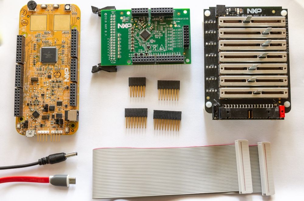

2.1.2 MC33772BSPI (3 up to 6 cells battery pack) Setup
  1. S32K144 EVB
  2. FRDM33772BSPIEVB + connectors
  3. BATT-6EMULATOR + ribbon cable
Before going to the next step, the solder jumpers for the FRDM33772BSPIEVB board must be configured in order to make it compatible with the S32K144EVB. This process is detailed both in the UM1143 [4.1] Table 3 or  User-Guide [4.3] Table 11. Jumper setting to work with S32K144EVB. The J26 & J36 must be unsoldered while the J27 (1-2), J37 (1-2),  JP30(2-3) and JP31(2-3) must be resoldered.  Without these settings, the communication on the EVBs will be unsuccessful.

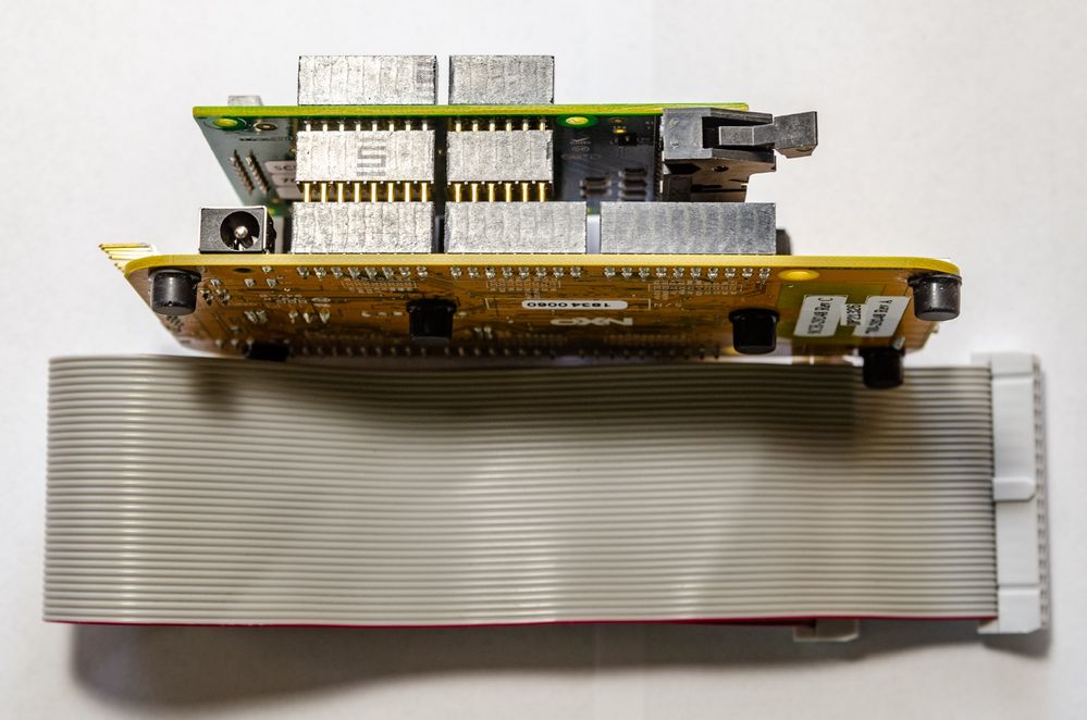

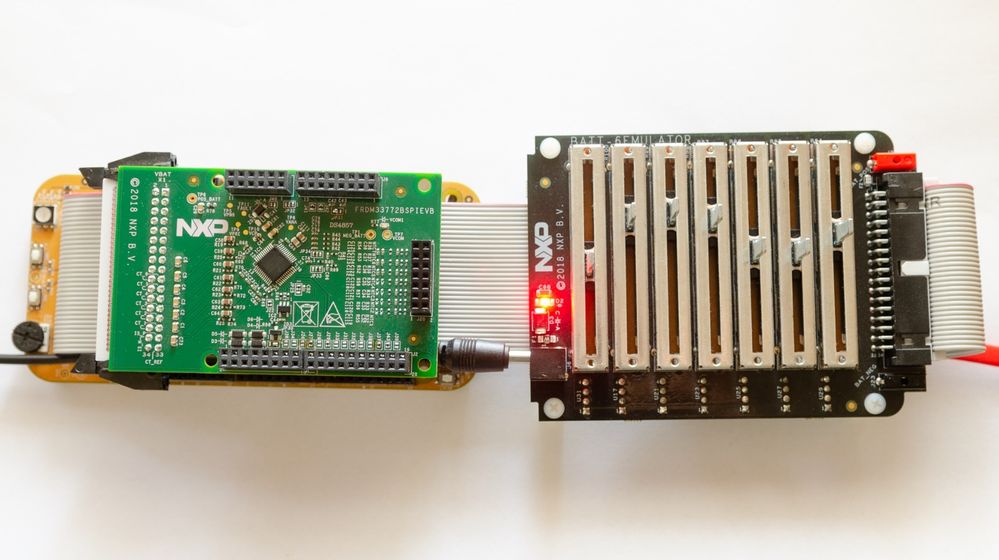

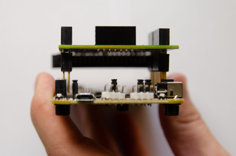

  1. First, you have to attach the double connectors that come with the MC3377xBSPI boards to the S32K evaluation board. You will notice that the BCC board is smaller than the S32KEVB, so the external connectors row of the BCC board will align to the internal rows of the S32K evaluation board. The following two images describe the connection setup. The FRDM3377xBSPIEVB.J9 aligns with the S32K144EVB.J3 (J9.2 with J3.1)
  1. Connect the Battery Emulation board with the FRDM3377xBSPIEVB via the ribbon cable provided in the same box with the BATT-xEMULATOR board.
  2. Power up the BATT-xEMULATOR board with the 12V via a power jack of 3.5mm
  3. Connect the S32K144 EVB via the micro USB cable to the PC.
Be aware that the MC3377xB chip is powered up by the cells, in our case the Emulator. The emulator has to be powered up in order to have successfully communication between the BCC and the main MCU. The final setup will look like this.

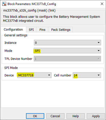

In the Configuration TAB, the user must choose the communication mode (SPI/TPL), the device type (MC33771B/MC33772B), and the Cell number connected to the Battery Cell Controller.
The SPI tab refers to the LPSPI peripheral. In the case of the SPI communication mode, only one LPSPI instance is required. The dropdown options will be populated only after one of the LPSPI Configuration blocks were added to the model displaying their instance number. Here the user must set the Chip Select pin number that is going to be used for BCC selection during communication. If the user presses on the “Config for BCC as Master” button, then the right values will be set in the LPSPI Config block.

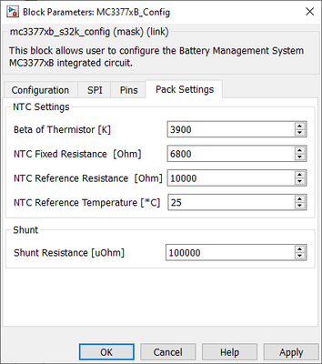

The last tab lets the user specify the NTC thermistors characteristics and the shunt resistance value. These values are used by the MC3377xB_GetValues block, to automatically convert the RAW values, provided by the Battery Cell Controllers into values delivered in common measure units like Amps and *C. If the user wants to read only the RAW values and not to automatically convert the block, this tab must be ignored.

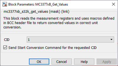

The first method uses MC3377xB_Get_Values Block. As you can see in the previous image, this block returns all the measured values directly in Volts, Amps, and degrees Celsius. The conversions from RAW values are based on the parameters inserted in the Pack Settings tab of the MC3377xB_Config. The Cells Voltage returns always a 14 uint32 array, the maximum cells number. The user must ignore the values that are not used. The same scenario is applied for the NTC Temperatures because the MC3377xB can measure up to 7 thermistors.
The MC3377xB_Get_Values block has the following options:
  1. CID – this selects the BCC number that will provide the values.
  2. Send Start Conversion Command for the requested CID – if this option is checked, then the block will insert automatically the code that will send the start conversion command and waits until the conversions are performed.  If the checkbox is not checked, then the block will only read and converts the values.

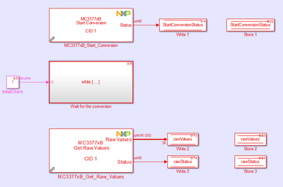

For reading the raw values, then the following approach can be used.
  1. Start the conversion using the MC3377xB_Start_Conversion block for initializing the ADC conversions.

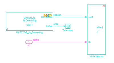

  2. Then, the application needs to wait until the conversion is done. For this, the dedicated MC3377xB_Is_Converting block must be used. Below there is the content of the WHILE body, using the MC3377xB_Is_Converting.
  1. Now that the conversion is complete, we need to read the raw values from the BCC controller. The block MC3377xB_Get_Raw_Values returns a 30 UINT16 values array that contains all the measured values. For the MC33772B, the block will return still 30 values, all the cells from 7 to 14 voltage raw values will be 0.

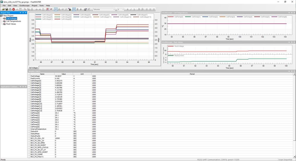

This article comes with the examples described above. Running the models on your setup could be a good starting point for your project. Once the code has been successfully generated and deployed on the target, the FreeMaster can be connected to the board via UART and the values can be monitored on the Host PC, just like in the application below.
