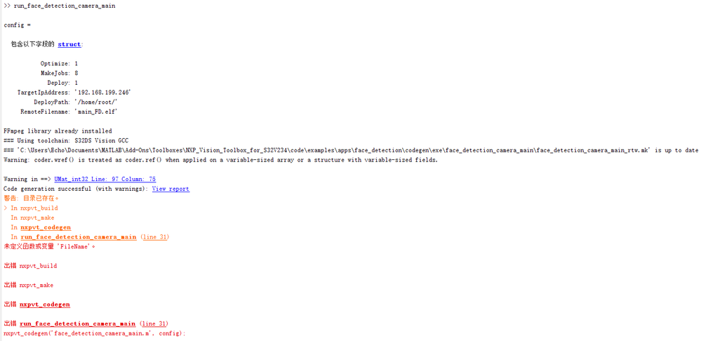

Hi, deniel. I have a problem about the nxpt_codegen() here.
I configured my envirement step by step following this attached instrument, and I did complete the there vision applications of 3.2.
But when I went to Chapter3 -- Face Detection on S32V234 Vision Processor, after I invoked run_face_detection_camera_main.m in MATLAB console, errors were reported as follows. I couldn't find the cause nor solution of this probelm, is there something wrong of my GNU/APU? I hope you can give some advice. Thank you very much.
FFmpeg library already installed
### Using toolchain: S32DS Vision GCC
### Creating 'C:\Users\Echo\Documents\MATLAB\Add-Ons\Toolboxes\NXP_Vision_Toolbox_for_S32V234\code\examples\apps\face_detection\codegen\exe\face_detection_camera_main\face_detection_camera_main_rtw.mk' ...
Warning: coder.wref() is treated as coder.ref() when applied on a variable-sized array or a structure with variable-sized fields.
Warning in ==> UMat_int32 Line: 97 Column: 75
Code generation successful (with warnings): View report
No function or variable is defined 'FileName'。
Error nxpvt_build
Error nxpvt_make
Error nxpvt_codegen
Error run_face_detection_camera_main (line 31)
nxpvt_codegen('face_detection_camera_main.m', config);

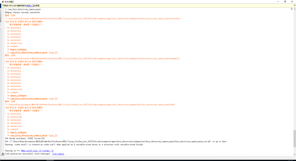

Hi, Paul,
I'm using Matlab 2018a.
And I've tried the new nxpvt_build.p  you provided, but it doesn't work either. But the errors seems a little bit different from before.
Hi echo.chen@calmcar.com‌,
Can you copy the entire output from Matlab console window and paste it here?
