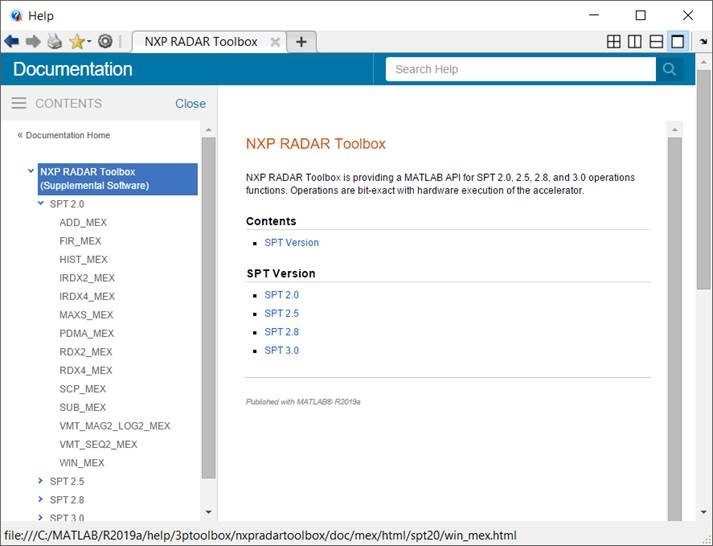

  • Integrate Help and Examples into MATLAB documentation framework. Opening the MATLAB Help will show new section of “Supplemental Software” for Model-Based Design for SPT Toolbox.

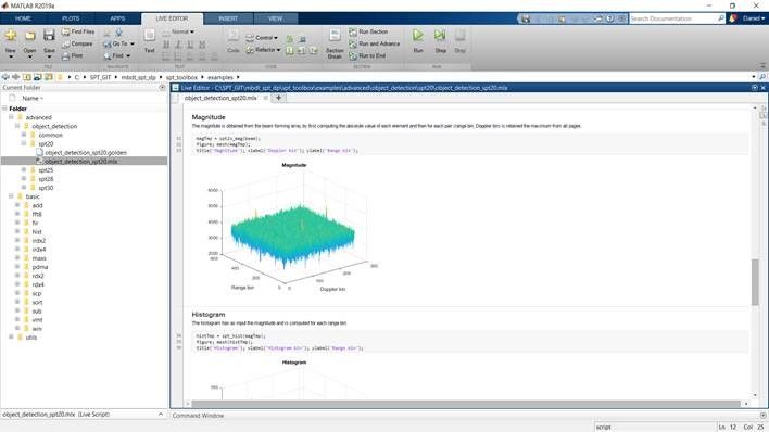

  • Redesign all SPT Toolbox examples and added a new standalone RADAR application to showcase object detection capabilities with RADAR SPT instruction: range FFT, doppler FFT, beamforming and peak search

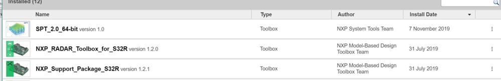

Our customers used SPT2.0 with NXP_RADAR_TOOLBOX1.2.0 to run SPT_Example.m normally, but after upgrading to NXP_RADAR_TOOLBOX1.3.0, some errors occurred. Please help to check the reason.
The picture is as follows:
SPT2.0+NXP_RADAR_TOOLBOX1.2.0  is OK
SPT2.0+NXP_RADAR_TOOLBOX1.3.0 have some issues.

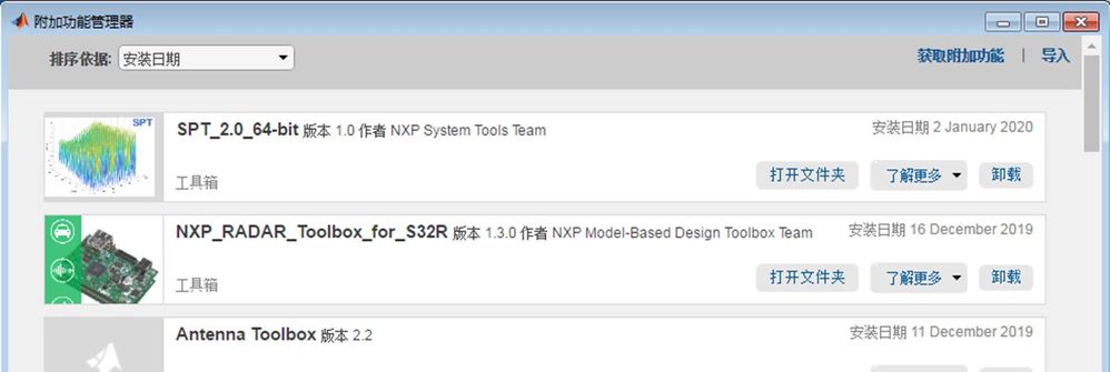

Hi,Hao Ren:
I have the same problem with you,having taken a lot time but  failed to solve the problem,could you please tell me how to solve the problem? appreciate very much!
Hello nxf47389‌,
You should uninstall the toolbox SPT_2.0_64-bit. This is one of the earliest version of NXP_RADAR_Toolbox_for_S32R.
The error is because there was added a new argument to the following mex files: rdx2_mex, rdx4_mex, irdx2_mex, and irdx4_mex.
