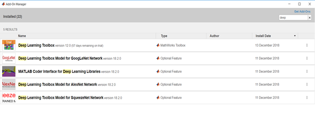

  1. Software delivered by MathWorks:
    • MATLAB (we assume you have already installed and configure this). As a hint, please make sure the MATLAB is installed in a path with empty spaces;
    • MATLAB Coder is the key component that allows us to generate the C++ code that will be cross-compiled to be executed on the target;
    • Image Processing
    • Computer Vision System allows us to perform various interactions with the data captured from the camera;
    • Deep Learning Toolbox allows us to use pre-trained networks or re-train and re-purpose them for other scenarios;
    • and various other support packages that are detailed in the next chapters;

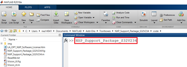

2.1 Installation and Configuration for NXP Support Package for S32V234

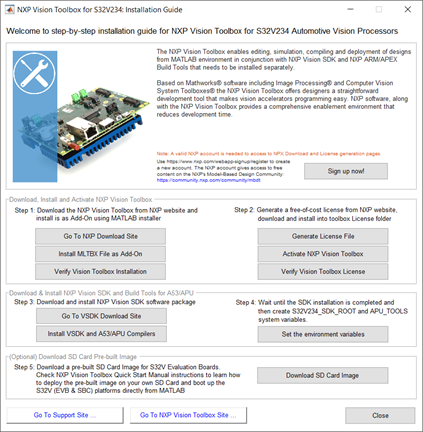

For convenience a step-by-step installer guide is available on MathWorks’s File Exchange website. Open MATLAB and select Get Add-Ons:
  1. Once the Add-On Explorer window opens, search fornxp vision toolbox s32v
  2. Select the NXP Support Package for S32V234 and click on Add button to start the installation of the installer guide into your MATLAB instance.
  3. Wait until the toolbox is installed and then click on Open Folder button.
  4. Run the NXP_Support_Package_S32V234 command in your MATLAB console to start the Installer Guide.
  5. The NXP Support Package for S32V234 - Installer Guide User Interface is started
The Installer Guide contains instructions for downloading, installing and verification of all software components required for being able to develop vision application with MATLAB for NXP S32V234 automotive vision processors:
  • Steps to download, install and verification of the NXP Vision Toolbox for S32V234
  • Steps to generate, activate and verification of the license for NXP Vision Toolbox for S32V234
  • Steps to download and install NXP Vision SDK package
  • Steps to configure the software environment for code generation
  • Steps to download additional software

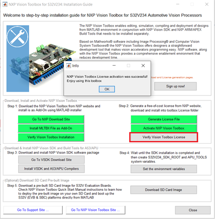

There are 2 main advantages of using this Installer Guide:
  • Each step completion is automatically checked by the tool. If the action is completed successfully, then the tool is going to mark it as green. If a particular step cannot be verified, then the tool will issue a warning or error and is going to highlight in red that particular step that needs more attention for user side.
  • Future updates will be made available via this online toolbox. In case you wish to keep your software up to date, then please install this into your MATLAB Add-ons and once a new update will be available your MATLAB instance will notify you.

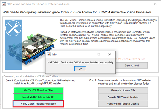

The next screen capture shows how the Installer Guide notify user of successful or failed actions. At the end of installation all push buttons should be green.

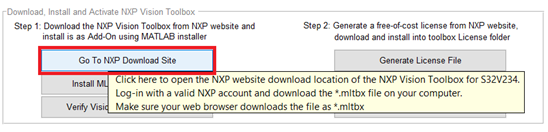

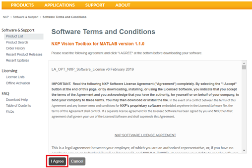

 You can obtain the NXP Vision Toolbox for S32V234 by:
  1. Using the Installer guideGo To NXP Download Sitebutton
  2. Go directly into your NXP Software Account and download the toolbox using this link
No matter which option is used, the NXP Vision Toolbox for S32V234 installation steps are similar: once you have the toolbox on your PC, double click on the *.mltbx file to start the MATLAB Add-ons installer that will automatically start the installation process.

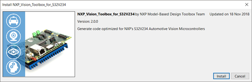

You will be prompted with the following options:
  1. The NXP’s Vision Toolbox Installation Wizard dialog will appear. ClickInstallto proceed.
  2. Indicate acceptance of the NXP Software License Agreement by selectingI agree to the terms of the licenseto proceed.
  3. ClickOKto start the MATLAB installation process. The rest of the process is silent and under MATLAB control. All the files will be automatically copied into default Add-Ons folder within MATLAB

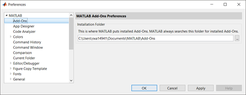

  4. The default location can be changed prior to installation by changing the Add-Ons path from MATLAB Preferences
    After a couple of seconds, the NXP’s Vision Toolbox should be visible as a new Add-ons. pastedImage_31.png

  7. In case you are using the Installer Guide, then you have the option to check if the NXP Vision Toolbox is installed correctly on your MATLAB environment by simply clicking onVerify Vision Toolbox Installationbutton
  8. After this step you should see all button related with Vision Toolbox Step 1, green

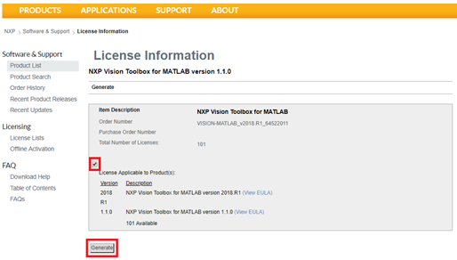

2.2 License Generation and Activation

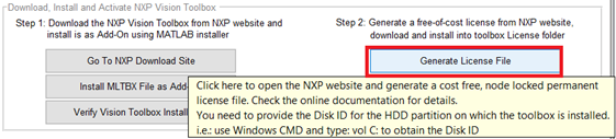

The NXP Vision Toolbox for S32V234 is available free of charge, however, a valid license is required. You can obtain the NXP Vision Toolbox for S32V234 license free of charge by:
  1. Using the Installer guide “Generate License File” button
  2. Go directly into your NXP Software Account and Generate the license using this link

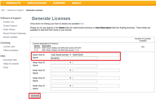

Perform the following steps to obtain the NXP Vision Toolbox for S32V234 license. For the first-time log-in, theSoftware Terms and Conditionspage will be displayed. Click onI agreebutton to consent to the software license agreement.
In this section we presume, you already logged into your NXP account to download the toolbox prior to license generation step
  2. Verify if the correct tool and version are identified and then check the box and click onGeneratepastedImage_54.png
  3. Select Disk Serial Number or Ethernet address as theNode Host ID”. If you do not know your Disk Serial Number nor the Ethernet address then check the link available on this page with details about License Generation. Enter a name for license to help managing them in case you need to use the Vision Toolbox on multiple computers. (Optional)pastedImage_58.png

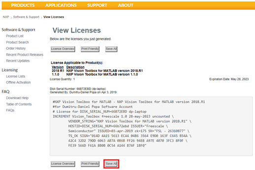

  4. Click on “Generatebutton to get the license. Verify if the information is correct: Toolbox version, expiration date, Node Host IDpastedImage_59.png
  5. Either click on “Save All” or copy and paste the file into a text editor, and save the file as “license.dat” into the “Vision Toolbox installed directory\license” folder.
In case you are using the Installer Guide, then you can save the license file anywhere and use the “Activate NXP Vision Toolbox” option to make sure the license is copied correctly in the appropriate toolbox location. Check if the license file is installed correctly by using the “Verify Vision Toolbox License” button. If everything is ok, then the Installer Guide will confirm the action.
Alternatively, you can check from command line is the license for NXP Vision Toolbox is activated. Run the command nxpvt_license_check. If there are issues with the license, this command will return the root-cause.

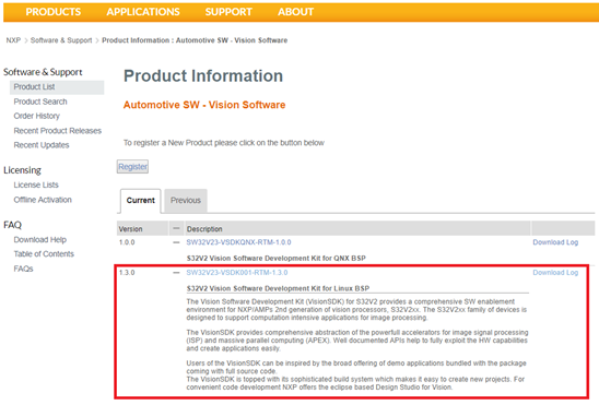

2.3 Installation of NXP Vision SDK and Build Tools
All the code generated by NXP Vision Toolbox is based on S32V234 Vision SDK package. This software package is also free of charge and apart of optimized kernels and libraries for the S32V automotive vision processors, it also contains the build tools to cross-compile the MATLAB generated code to ARM A53 and APEX cores. You can obtain the S32V234 Vision SDK free of charge by:
  1. Using the Installer guideGo To VSDK Download Sitebutton
  2. Go directly to NXP website
Perform the following steps to obtain and install the S32V234 Vision SDK and NXP Build Tools:

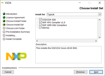

  1. Download the Vision SDK RTM v1.3.0 on your PC. Due to the size of the package this might take a while.pastedImage_64.png
  2. Once the VisionSDK_S32V2_RTM_1_3_0.exe download is finished, selectInstall VSDK and A53/APU Compilersoption in the Installer Guide UI.
  3. Select the exe file and wait for the Vision SDK Install Anywhere to start. pastedImage_66.png
  4. Make sure you follow all the steps and install the:
    • NXP APU Compiler v1.0 – used to compile the generated code for APEX Vision Accelerator
    • NXP ARM GNU Compilers – used to compile the generated code for ARM A53
    • MSYS2 – used to configure the bootable Linux image and to download the actual vision application to the S32V234 Evaluation BoardpastedImage_67.png

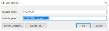

2.4 Environment Setup

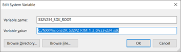

The last step required for software configuration is to set two system or user environmental variables APU_TOOLS and S32V234_SDK_ROOT that points to:
APU_TOOLS= C:/NXP/APU_Compiler_v1.0
S32V234_SDK_ROOT = C:/NXP/VisionSDK_S32V2_RTM_1_3_0/s32v234_sdk
Ensure system or user environment variables, corresponding to the compiler(s) you have installed, are defined to compiler path value as shown below:
Paths shown are for illustration, your installation path may be different. Once environmental variables are setup you will need to restart MATLAB to use these variables.
An alternative for setting the system paths manually is the “Set the environment variables” option from the NXP Vision Toolbox support package installer:
If the MATLAB is open with Administrator rights, then the “Set system wide” can be used to set the system variables. Othervise (most of the cases) use “Set user wide” to setup the environment variables

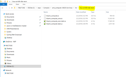

In order to use the Convolution Neural Networks the ARM_COMPUTELIB variable should also be set to point to the top of the arm_compute installation. More on the ARM Compute library installation in the following chapter.

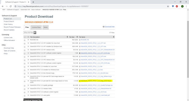

2.5 SD-Card Configuration

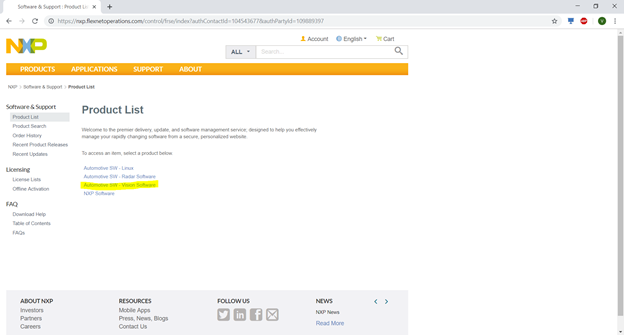

The entire procedure for configuration and booting up the platform is described in the Vision SDK manuals. Unfortunately, not everyone has access to a Host PC with Linux OS to configure an SD card (formatting, uboot, filesystem, linux image copy).  To do this, you must log into your NXP account at www.nxp.com and download the SD card images:

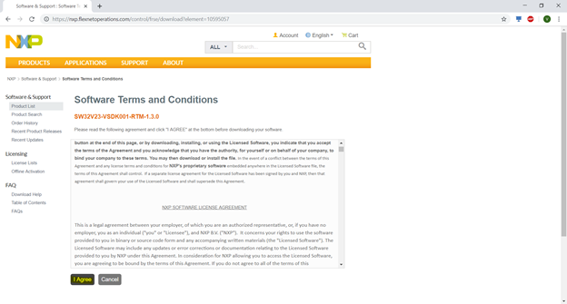

  1. From the My account page go to “Software Licensing and Support”, then click on “View accounts” from the Software accounts panelpastedImage_3.png
  2. Click on the “Automotive SW – Vision Software” link:pastedImage_5.png
  3. Select the latest SDK (at the being SW32V23-VSDK001-RTM-1.3.0 pastedImage_6.png
  4. Agree with the terms and conditions:pastedImage_7.png
  5. Then click on the SD card image based on Yocto:pastedImage_9.png
Unpack the downloaded file and the build_content/v234_linux_build/s32v234sbc/’ folder will contain the sbc SD-card image which can be written directly from MATLAB.

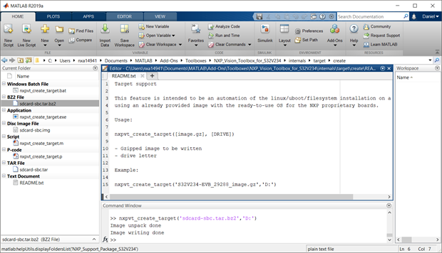

Follow the next steps to create a bootable SD card for S32V234 SBC evaluation board:
  1. Begin by inserting a microSD card with at least 4GB capacity in your Host PC running Windows OS. The Windows OS should be able to recognize the SD card and assign a drive letter (e.g.: “D:”)pastedImage_4.png
  2. From MATLAB command window run the command:
      nxpvt_create_target('sdcard-sbc.tar.bz2', 'D:');
    This example assumes you have untar the SD Card archive downloaded from the NXP website and you run the nxpvt_create_target command from the same directory as sdcard-sbc.tar.bz2 image
    This command will format the card and then it is going to copy all the required files from the *.bz2 image to the SD Card for booting up the Linux on S32V234 SBC.
  3. The copying process might take a while depending on the SD Card class type. During the process the following message will be shown on the screen.Wait until the copying process is finished and the “Image writing done” message is displayed on the MATLAB command prompt
  4. After the copying process is completed, you should be able to see an additional drive mapped on your system (e.g. E) that cannot be accessed since it is an ext3 file system type.
  5. Check that the initial mapped drive (e.g. D) contains: Image and s32v234-sbc file

After downloading and unpacking the ARM Compute image the ARM_COMPUTELIB should point to the top of the installation folder:
The ARM Compute library should contain the linux-arm-v8a-neon with the correct libraries:
To be able to run the CNN examples in the toolbox, the following MATLAB Add-Ons should be installed :
  1. Deep Learning Toolbox
  2. Deep Learning Toolbox™ Model for GoogLeNet Network
  3. Deep Learning Toolbox™ Model for AlexNet Network
  4. Deep Learning Toolbox™ Model for SqueezeNet Network
  5. MATLAB Coder Interface for Deep Learning Libraries
