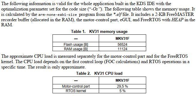

There are a few things I don't understand about this reference .
1. The Freemaster task is driven by serial port interrupts. In the document AN5309, I read some instructions for this.But I still don't understand the implementation of the Freemasterre task and the serial port interrupt service routine
2. As for the CPU utilization statistics, the document gives the CPU load of the Motor Control part and the RTOS kernel. Does the Motor Control part include ADC interrupts and PDB interrupts?Or just a few FreeRTOSde tasks?

Hello xgy_upc,
There is some additional documentation that explain FreeMASTER in a bit more detail, which can be found on the following landing page:
https://www.nxp.com/design/software/development-software/freemaster-run-time-debugging-tool:FREEMAST...
I would also recommend looking at the following User Guide which covers the initialization of the FreeMASTER GUI tool for controlling motor-control applications.
https://www.nxp.com/docs/en/user-guide/PMSMCRSPUG.pdf
As for the CPU load, please note that it is approximate, but the motor-control part does the ADC_ISR handler and Programmable Delay Block.
I hope that this information helps.

1. I want to ask about the implementation of the Freemasterre task and the serial port interrupt service routine in the PMSM reference program based on FreeRTOS
2、2. In CPU load statistics, the motor control part only includes ADC_ISR handler and Programmable Delay Block.?
