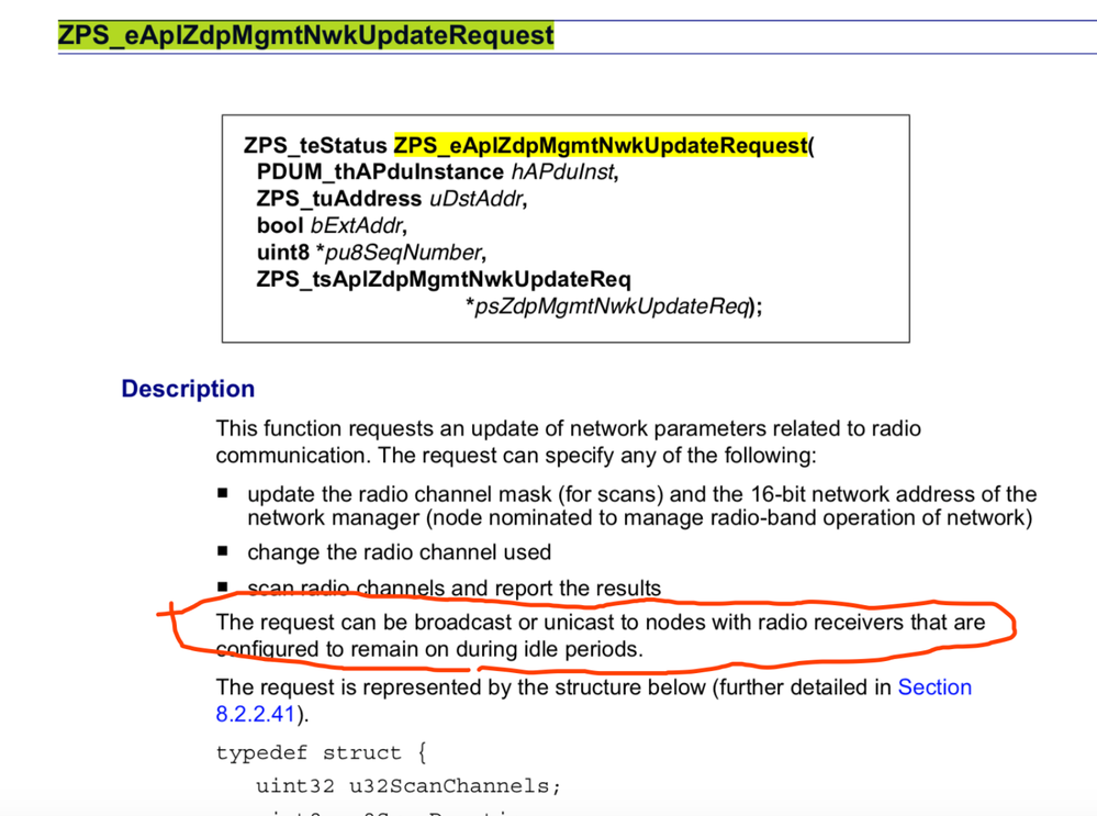

At the same time, I found the following paragraph in the introduction to this function
"node with radio receivers that are configured to remain on during idle periods"
Does that mean the terminal device needs to do some configuration or something?

To let a device receive information while in idle mode, there's an MLME command that can be sent with the RxOnWhileIdle request type, and a value of TRUE. This changes a setting in the end device so it can leave it's radio active at all times, even when on IDLE, allowing it to receive data during this period.
Could you please provide a sniffer log when sending the ZPS_eAplZdpMgmtNwkUpdateRequest to see if there's some error reported during this process?

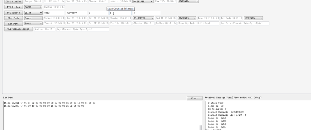

854648943
Hi,Sebastian Delrio
I found that when i set scancount to 1, i can use this function normally.

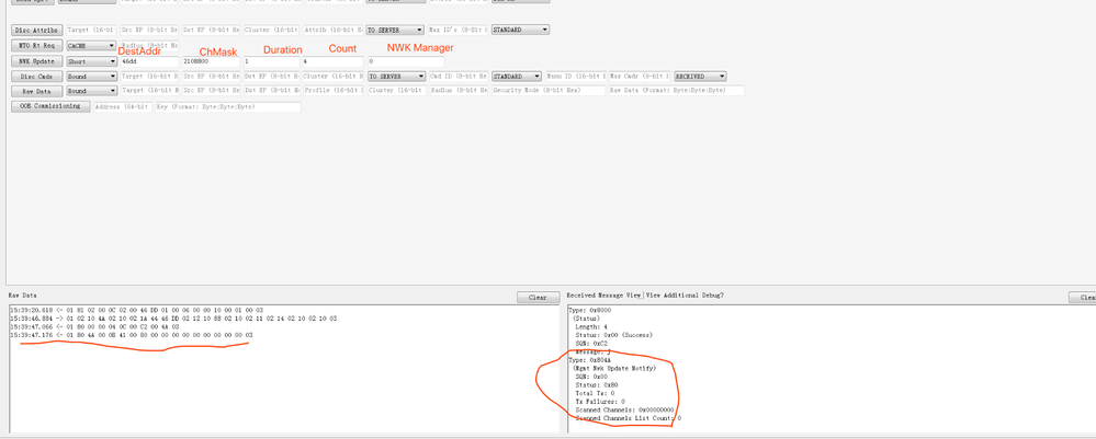

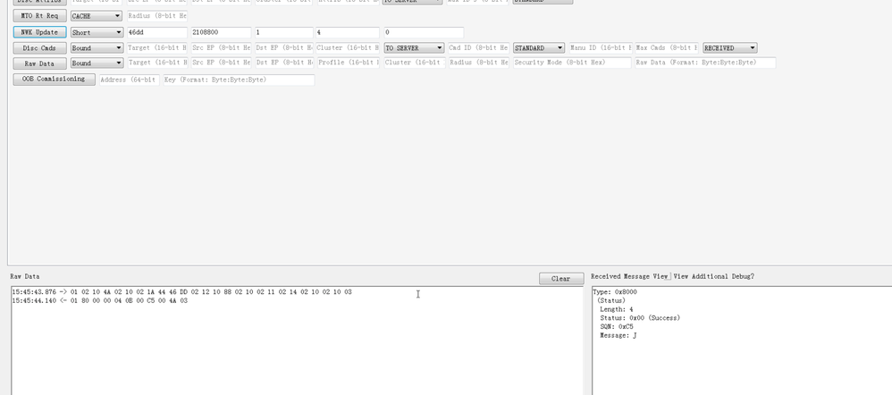

I tried to use this function ZPS_eAplZdpMgmtNwkUpdateRequest, but there were some problems. In order to operate through ZGWI software on the basis of JN-AN-1216 code,But I ran into some problems, and my coordinator used JN-AN-1216, and I used the ZGWUI tool to call this function, but I replied to all 0.
When i sent this request to the terminal more than twice, i found that the coordinator could not receive a response,And the terminal can't get a new apud.
Sebastian Delrio I need your help. Thank you very much.
