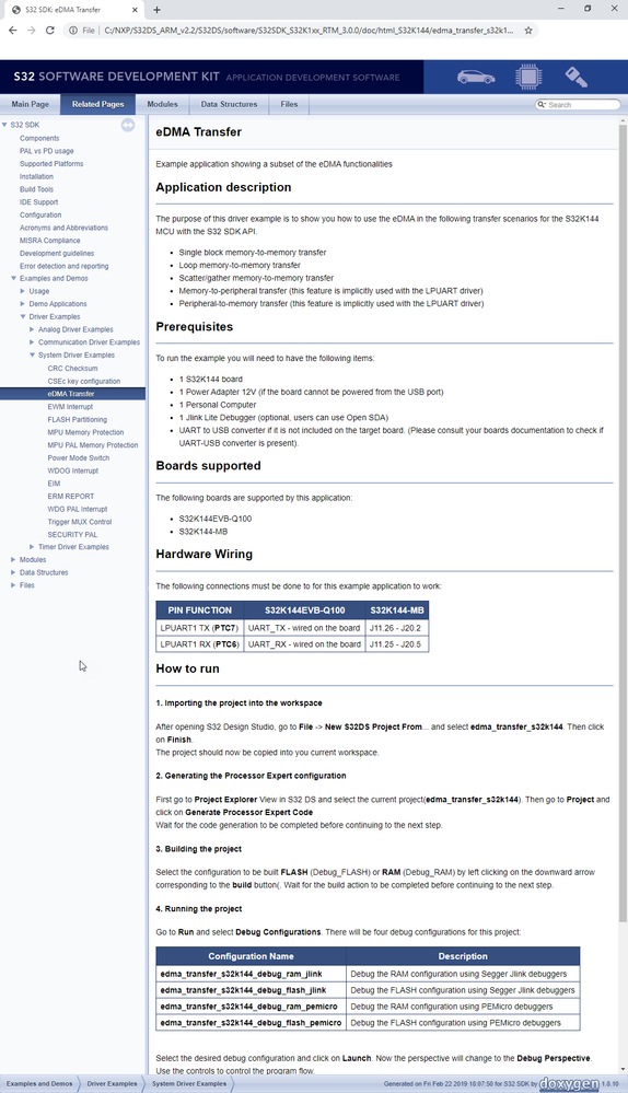

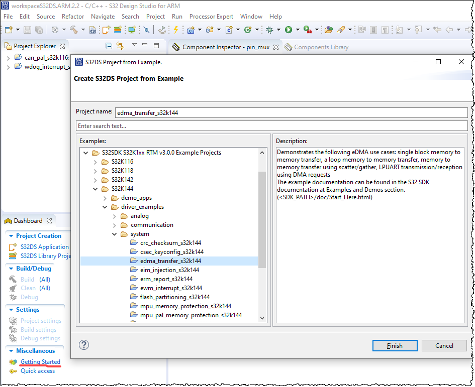

Hi 余 帅,
I can only find the "Example_S32K144-Flash_RW_simple-S32DS12.zip" in who can give me the method of operation about s32k144 flash,such as example of the code and informat....
Would you please refer the DMA example in S32DS.ARM2.2?
