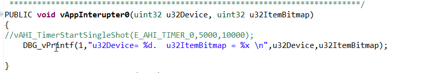

I want to use E_AHI_TIMER_0 to generate an interrupt。

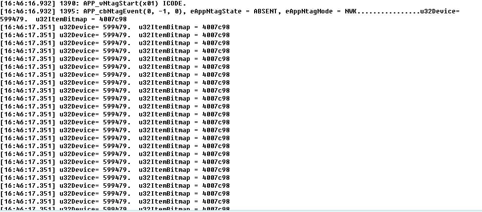

But I ran into some problems, and I found that I only triggered an interrupt, but the program repeated my registered
interrupt function until the watchdog reset.
The SDK is SW-4170
 Device is JN-AN-1217 Base device Router
 Excuse me, where did I configure it incorrectly?

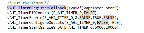

Here are some of my configurations
1.Initialize timer 0

The issue could be related to an uncleared interrupt flag causing the interrupt to be constantly repeated, thus, causing a watchdog reset.
Could you please check to see if you added the following API to clear the interrupt flag?:
(void) u8AHI_TimerFired(E_AHI_TIMER_0);‍
Please let me know if you still have issues.
Sebastian

With your help,I've solved the problem. Thank you very much.
