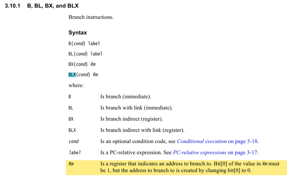

__asm("ldr r1,=0x1005");
__asm("blx r1");

first point which I recommend to everyone - make sure that you have disabled all interrupts before jump (on all levels: in the core and also by local enable bits in peripherals) and it's good practice to put everything back to default state before jumping to application. This can save a lot of troubles.
Does r1 contain correct entry point address? Is bit[0] set to '1'?
