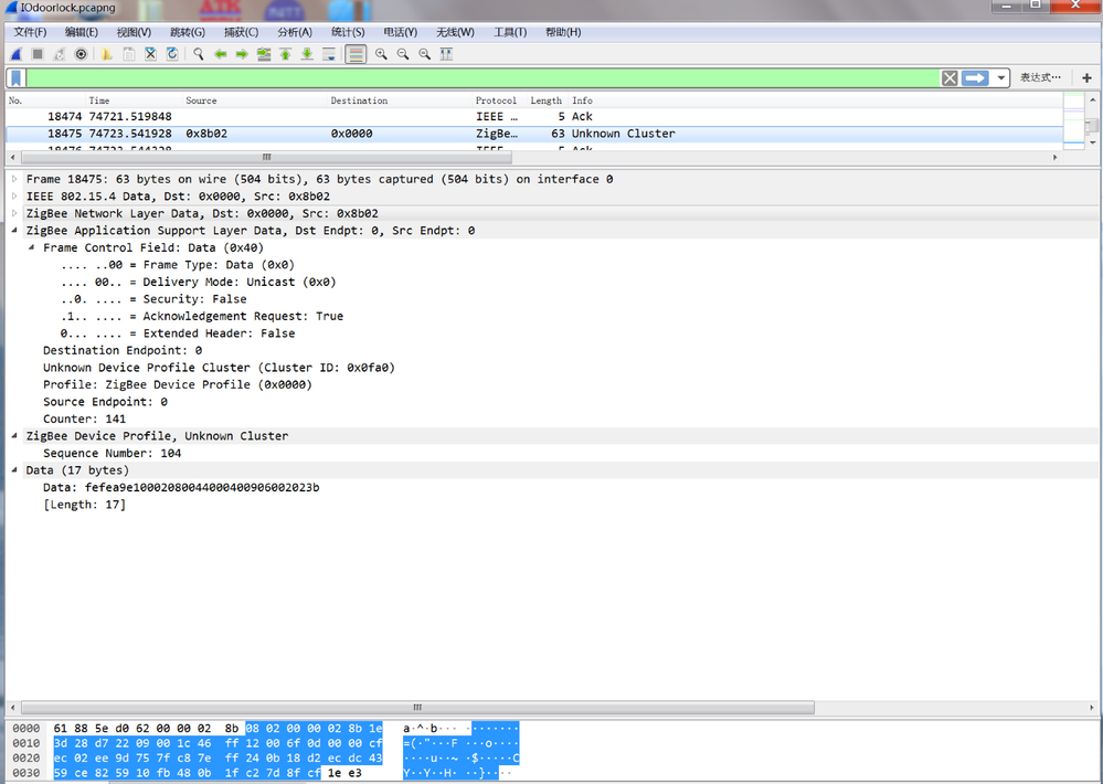

We are docking zigbee devices, their devices are a custom cluster, and then put in the data, to send.
I need to extract the contents of the received frame of data.
But I didn't find out where there was an interface in the SDK-JN-4170 that prompted me to get this message.
I manually created a cluster, like him on the coordinator, and then I found that when I received the message (figure above), I automatically replied to a frame of message (figure below).
But I still don't know how to extract this data, and where to instruct me to receive this frame of data.

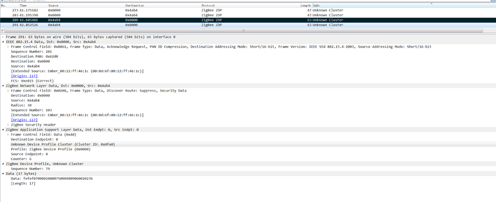

Could you please provide a sniffer log to see the process of the data request and the message you're getting as a response?

This is the relevant information I got, and when the child device sends a message to the coordinator, the type of message is unknown Cluster,
I need the data in this frame of message, but when the frame message arrives, I can't get any instructions, such as APS DATA Indication, so I want to know where I can get instructions when the message arrives.

To discover the existing clusters in a determined endpoint with a JN-AN-1216 Coordinator, you can send an Active Endpoint request to your End Device's short address, followed by a Simple Descriptor request of the endpoint containing the cluster you want to know information about.
If the custom cluster is discoverable, you will get information about it in the Simple Descriptor response.

I found that the End device sends data through custom cluster 0x0fa0 in endpoint -0.
The coordinator receives the message and does not send the events to APP_vGenCallback( ). So when the data for these custom
clusters arrives, there is no event that tells me where to extract the data.
I don't know how to add a custom cluster of 0x0fa0 under endpoint 0 so that messages sent by the device can be callback into this function APP_vGenCallback

Now that i've solved the problem,  I added a custom cluster under endpoint 0 in the configuration file.
Use this function ZPS_eAplZdoRegisterZdoFilterCallback to register a callback function to receive, and now the data is available
