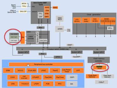

1. FlexRAM is slower than SRAM
Please see the attachment. (it's from AN11983 p11)
When I see flash memory map, I think FlexRAM is also contiguous addresses.
but this is saying non-contiguous...
and is that why the FlexRAM is slower than SRAM?
FlexRAM is not static RAM (SRAM)?

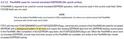

2. "a background pattern of all ones" ???
I saw "a background pattern of all ones" several times in NXP documents..
But I have no idea what it means since I'm not native English speaker,,
Please explain to me

1. This is given by architecture, not by the RAM itself. As you can see, the memories are sitting on different places which inserts some difference:
2. "background pattern of all ones"  means, that memory controller will initialize all bytes in FlexRAM allocated for EEE to "0xFF" (all ones) and then it will copy down valid data/records from backup flash. So, non-written words have default value 0xFFFFFFFF.
