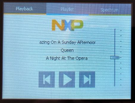

Three main windows/tabs on the GUI:
File playback
This screen shows:
• Album artwork/NXP logo
• Current track information (title, artist, album)
• Media controls (prev, play/stop, next)
• Volume slider

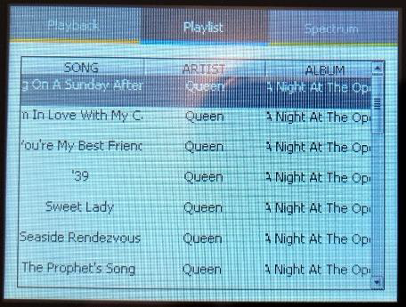

Playlist
This screen shows:
• Playlist information from mp3 files found in SD card
• A track for playback can be selected by touching the line

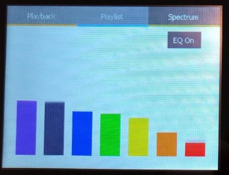

Spectrum visualizer
This screen shows:
• Seven vertical bars showing the frequency spectrum of the current track being played.
• Button for toggling Equalizer On/Off
o if on the sound is AM radio style
