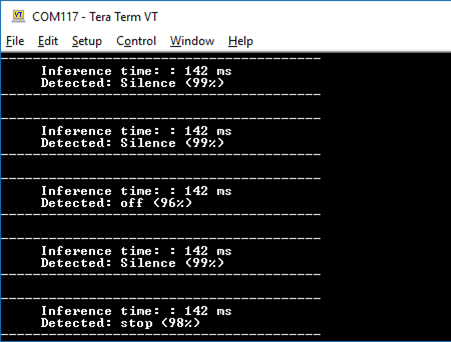

Application demo recognizes 10 keywords: "yes", "no", "up", "down", "left", "right", "on", "off", "stop", "go" spoken into the on-board microphone. Use terminal output - 115200 baud - to see results. This demo was created as part of hands-on lab demonstrating model conversion which can be found here: https://community.nxp.com/docs/DOC-344227.
Software
The RT1060 SDK should already be installed in MCUXpresso IDE. Drag-and-drop the .zip file into the Project Explorer view, and then compile and flash.
