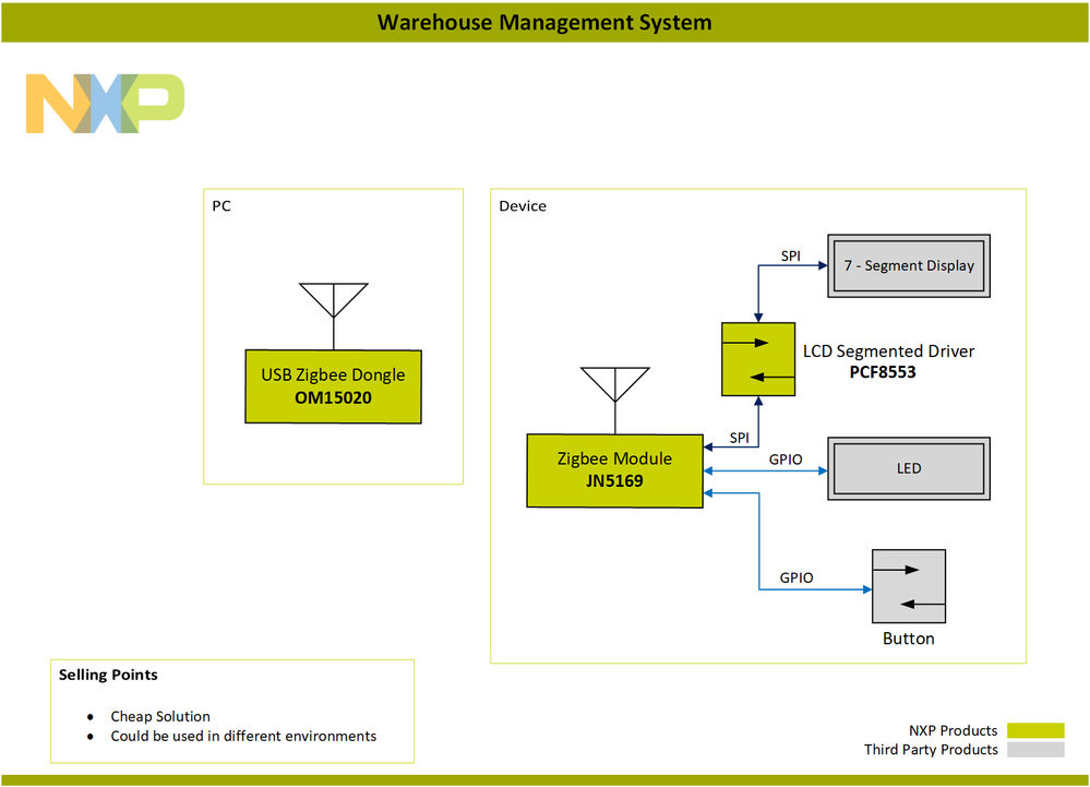

Block Diagram
Products
Category Zigbee
Product URL JN5169: ZigBee and IEEE802.15.4 wireless microcontroller with 512 kB Flash, 32 kB RAM
Product Description The JN5169 is an ultra low power, high performance wireless microcontroller suitable for ZigBee applications.
Category LCD Driver
Product URL PCF8553DTT: 40 × 4 LCD segment driver
Product Description PCF8553 is an ultra low-power LCD segment driver with 4 backplane- and 40 segment-driver outputs, with either an I²C- or an SPI-bus interface.
