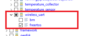

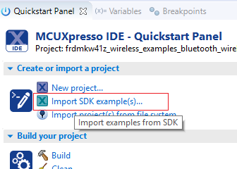

  1. Import the FreeRTOS version of the wireless_uart example included in the QN9080’s SDK.
Note: Be sure to select UART as your debug console.
