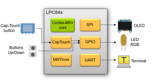

This is a very simple dodge the objects game. You are going to control a spaceship nave with the pushbuttons, one is use for up and the other to down, using the GPIO capabilities of the MCU. The on-board capacitive touch pad acts as start button and the game will prints in a terminal application as Tera term or also you can use an SSD1306 OLED display via SPI, the next picture show a block diagram of the project.

Block Diagram
