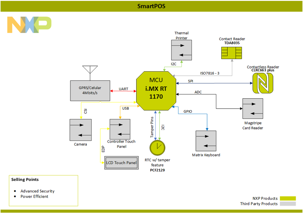

  • Contact card interface (TDA8035) and contactless card interface (CLRC663)
  • Supports the whole system to pass EMV Level 1/2 certification
  • Magnetic Strip Card Reader (MSR) supports 1/2/3 tracker, which could be implemented by ADC module
  • Tamper detection with more active pin pairs
  • Integrated encryption module/accelerator
  • High speed SPI interface to extend memory space
  • Secure boot
  • Code protection
  • USB/UART/SPI communication ports, etc.

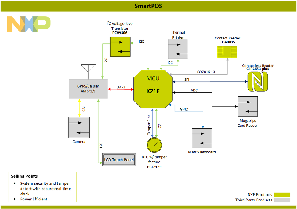

Block Diagram

Product URL 1Arm Cortex-M4|Kinetis K21 120 MHz 32-bit USB MCUs | NXP
Product Description 1The Kinetis K21 MCU features a hardware encryption coprocessor for secure data transfer and storage. Faster than software implementations and with minimal CPU loading. Supports a wide variety of algorithms - DES, 3DES, AES, MD5, SHA-1, SHA-256
Product URL 2i.MX RT1170 Crossover MCU Family - First Ghz MCU with Arm® Cortex®-M7 and Cortex-M4 Cores | NXP
Product Description 2i.MX RT1170 includes NXP’s EdgeLock™ 4A security subsystem, including secure boot and crypto engines
