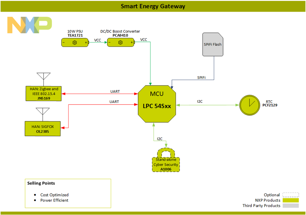

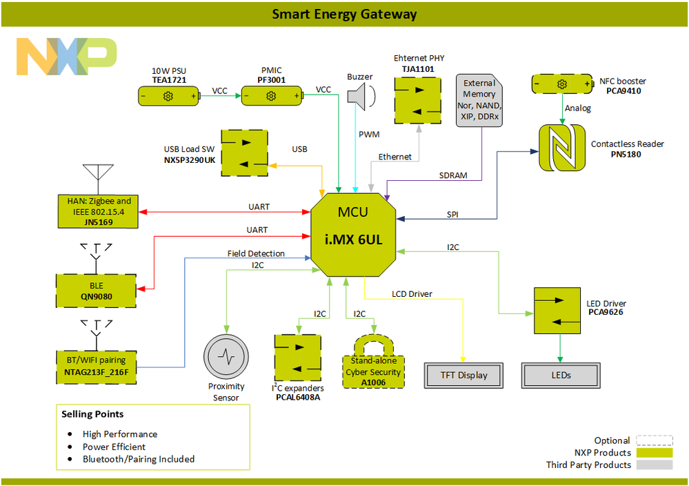

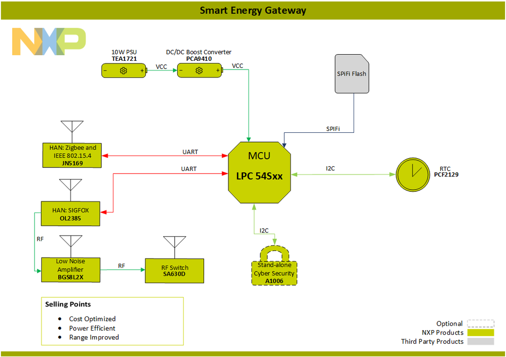

Faced with limited resources and booming demand, the energy industry seeks greater efficiencies within complex energy management and distribution processes, all while providing the best consumer experience. To achieve better service and smarter, streamlined processes, energy providers require reliable, real-time access to data.
This smart energy gateway device gathers data from the sensors around it and uploads that information to the internet where it is processed and shown to the user.
This solution has two approaches, one with a LPC MCU with low-power consumption and a Sigfox interface to send the data to. The other approach is with an i.MX 6UL MPU with Bluetooth, Ethernet and USB interfaces. Both designs share ZigBee® connectivity in order to communicate with the devices around it.
Features
  • LPC MCU offers low-power consumption
  • Sigfox interface to send data
  • i.MX 6UL MPU with Bluetooth
  • Ethernet interface
  • USB interface
  • ZigBee connectivity
Block Diagram
