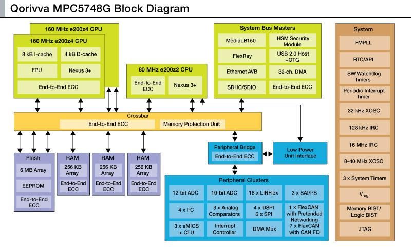

NXP's secure over-the-air communication for automotive networks features embedded hardware crystallographic engine for the rapid decryption of received data.
Features
  • MPC5748G targets High-End Body and High-End gateway
  • Rich communication peripheral set & HSM - embedded Security Module
  • Encryption, decryption, message code generation, secured flash memory for secured storage
  • Secured communication inside or outside the vehicle (wired or wireless)
  • Encryption with different algorithms demo
  • Decryption in both hardware (HSM) or software comparison
