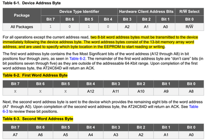

On S32G reference manual, we only ask customer to make sure I2C address of EEPROM is 0xA0, no others requirement.
Actually, S32G only supports EEPROM with one 8-bit address byte. For high capacity EEPROM such as AT24C64D@8K bytes, which need two 8-bit word address bytes. Can’t be supported by S32G ROM.
AT24C64D.pdf

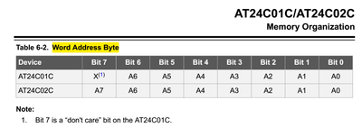

AT24C01 has been validated on S32G EVK board, which need one word address byte
AT24C01.pdf
