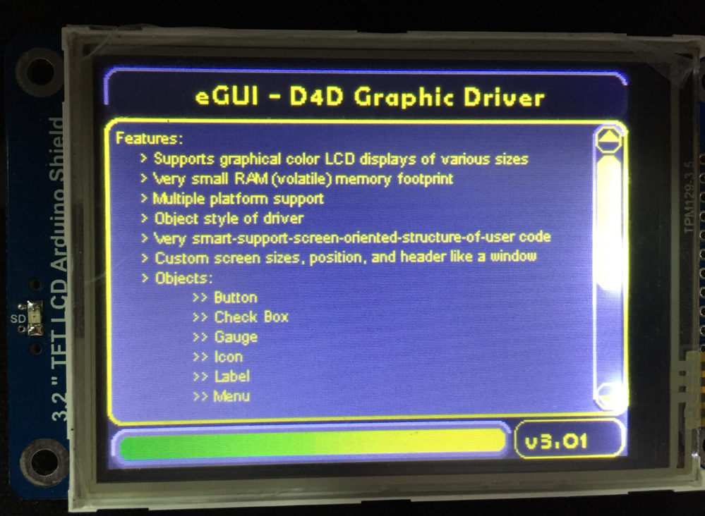

For showing text, graphics, animations in the LED panel, I decided to use the well known eGUI graphic library, porting the code to Kinetis SDK 1.3 + FreeRTOS and develop an eGUI low level driver for the LED panel.
http://www.nxp.com/egui
http://github.com/Gargy007/eGUI
This porting will have two goals:
  • Use the eGUI for controlling the LED panel
  • Use a QVGA display connected to FRDM-K82 to develop and simulate applications that will work in the LED panel

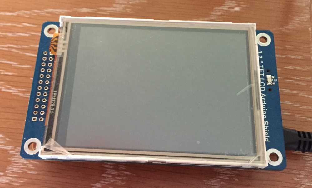

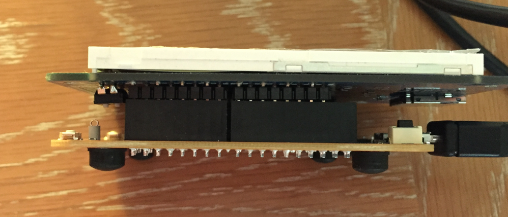

FRDM-K82 + Uctronics display:
eGUI Demo running:

Emulating the application that  will work on the LED panel is possible using the QVGA display:
Find attached  :
eGUI Porting to FRDM-K82 with KSDK 1.3 and FreeRTOS running the eGUI demo application
eGUI Porting to FRDM-K82 with KSDK 1.3 and FreeRTOS running the same application we will run in the LED panel. It also includes SEGGER_SYSVIEW.
