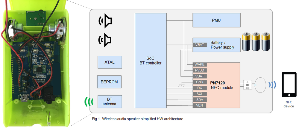

Hardware architecture
This demo consists of two speakers with the same components, and therefore, the same functionality. If we dismount one of the speakers, the components we can find in the device PCB are:
  • A system on chip solution, with an application processor, embedded flash memory and BT wireless connectivity.
  • A system crystal clock, the BT antenna and two audio speakers
  • A power supply unit, which includes three 1.5V batteries providing a stable 1.8V output.
  • A NFC reader module, based on PN7120 chip, with an integrated antenna and a compact form factor.

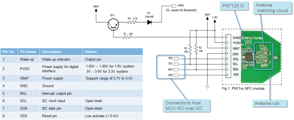

Application circuit for Bluetooth power on by NFC triggering
If we have a closer look to the power unit interface, we see that:
  • The VBAT pin is directly connected to the batteries. (PN7120 it supports a wide range of power supply voltages, from 5.5V down to 2.75V)
  • The pad supply (PVDD), for the host interface operation, is connected to the 1.8V from the PMU.
  • A wake-up trigger is built so that the BT controller is powered when an RF-field is detected.
Regarding the host interface between the NFC controller and the main system MCU:
  • The PN7120 module is connected to the BT controller via I2C slave interface. It supports standard, fast and high speed I2C modes (100 kHz SCL, 400 kHz SCL, 3.4 MHz SCL)
  • The corresponding pull-up resistors are connected on the data and clock lines (SDA and SCL).
  • The IRQ pin is used for ensuring the data flow control between PN7150 and the BT controller.
  • The VEN (RESET) pin, used for setting the device in hard power down mode.
And, in respect to the antenna interface:
  • The PN7120 VGA package
  • Some discrete components for the antenna matching
  • And the antenna coil surrounding the PCB edge.

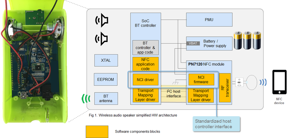

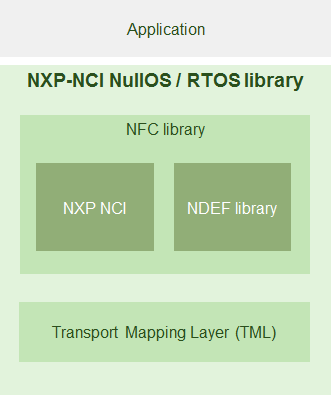

Software architecture and NCI interface
In this section, we detail the solution software stack and how the NFC application logic works within the overall system. Using the block diagram, we have added the software blocks in orange.First, the PN7120 module includes:
  • The NCI firmware & transport mapping layer for I2C communication (nothing to take care of from the developer side, since this firmware already comes embedded in the chip).
Similarly, the host controller side requires:
  • The NCI driver & transport mapping layer to communicate with PN7120
    On top of these layers, the application logic for the BT pairing is implemented.
Finally, the BT stack for the audio streaming, , but this software piece is not detailed here as it is out of the scope of the NFC implementation.

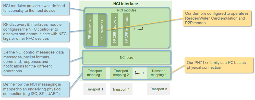

NFC controller interface (NCI) specification details
NCI describes the internal interface between an NFC Controller and the main host platform (in this case, between PN7120 and the BT chip). NCI is defined by the NFC Forum organization. As such, it provides manufacturers with a standard interface they can use for whatever kind of NFC-enabled device they build (making integration easier, saving time and effort). The next figure represents the NCI architecture:
  • At the bottom, we find the transport mapping blocks, which map the NCI protocol to an underlying physical connection (I2C, SPI, UART, etc)
  • The NCI core defines the messages, commands and data format for the different communications
  • On top, the NCI modules implement specific functionalities, like the RF discovery which configures the NFC controller to communicate with other NFC tags or devices.
From the overall NCI architecture, this implementation makes use of:
  • The transport mapping is the I2C block
    The RF discovery is configured so that the speaker iterates between the reader, card and P2P modes

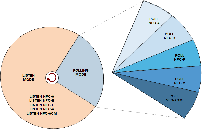

NFC controller interface: RF Discovery
PN7120 firmware can combine the three NFC modes of operation using the RF Discovery as defined in NCI spec. The RF discovery is a cyclic activity which activates various modes of operation. This consists of a loop which alternates two phases: The polling and the listen phases.
  • In the polling phase, the PN7150 acts as Reader or NFC Initiator for the P2P mode, searching for passive tags or an NFC target device.
  • If no card or target was detected, it enters a listening phase, to potentially be activated as card or P2P target
  • If no device to interact is detected in the polling or listening phase, it switches back to polling phase after a timeout.
All RF technologies supported by PN7120 can be independently enabled within this discovery loop. However, the PN7120 is in poll phase generates RF field and consumes current. Therefore, the more technologies to be polled, the larger the average current consumption.

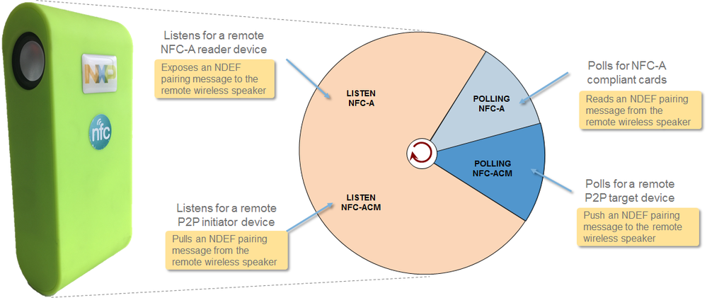

Multi-audio speaker prototype: RF dscovery configuration
To enable the speaker-to-speaker pairing functionality, each of the speakers needs:
  1. To have the capability to discover a remote speaker and initiate a pairing operation.
  2. Or the other way around, be discovered by a remote speaker to complete a pairing operation.
To accomplish this, the speakers need to sequentially move from polling and listening phases. As such, the discovery loop configured in the application iterates between reader, P2P and card modes.During the polling phase, the speaker generates an RF field, and uses an NFC-A polling sequence looking for:
  • A remote card or device in card emulation. If found, the NDEF data with the pairing info will be retrieved and processed.
  • Next, it looks for a remote P2P device. If found, it pushes an NDEF message with the pairing info to this remote peer.
On the other hand, during the listening phase, the speaker turns off its RF field and waits to be discovered by a remote device:
  • If it is discovered while operating as P2P target, it will pull an NDEF message coming from the remote speaker.
  • If it is discovered while operating in card mode, its NDEF message will be read by the remote speaker.
The precise communication that takes place between the two speakers will differ every time. It will depend on the polling loop status of both speakers at the instant they are tapped.

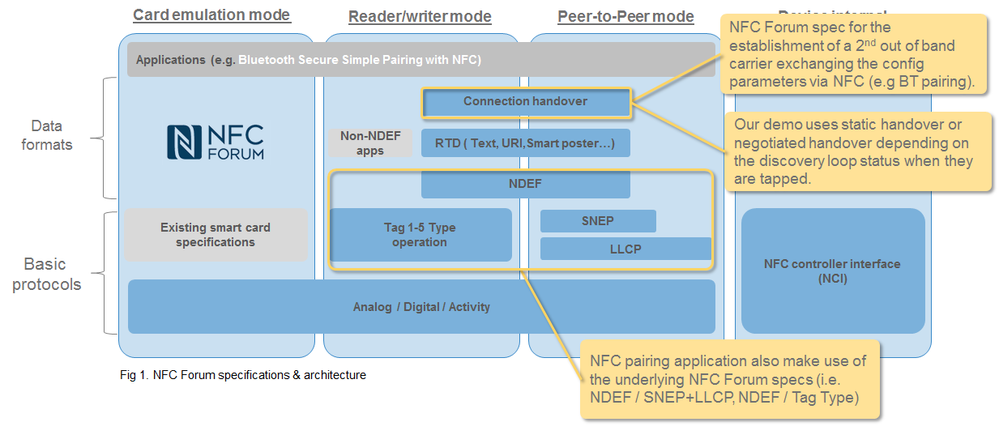

NFC Forum specifications
The NFC Forum organization defined a set of specs explaining how to exchange pairing data over NFC in an interoperable way with just a tap, independent of the manufacturer and without installing any dedicated application for it. These are:
  • Connection handover: This spec defines how two NFC devices can negotiate and activate an alternative communication carrier.
  • NDEF: The NDEF spec defines a message format to exchange data between NFC devices, including pairing data.
  • Tag 1 Type to Tag 5 Type specs: These specs define how NFC devices can interact with five different types of tag technology. As a result, any NDEF message store in any of these five types of tags will be processed by any NFC-compliant device.

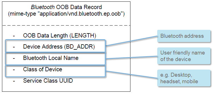

  • The reader processes the carrier data from the NDEF message and establishes a BT connection according to BT protocol.
The speaker in card emulation mode deploys a Handover Select NDEF record, advertising its BT carrier. In The NDEF message, we store:
  • The BT device address (MAC address)
  • Bluetooth local name (Friendly name for the user)
  • Class of the device (e.g. headset, mobile, etc)
This is the carrier data that will be used by the application to trigger the BT connection. After this proces, both devices start streaming music over BT.

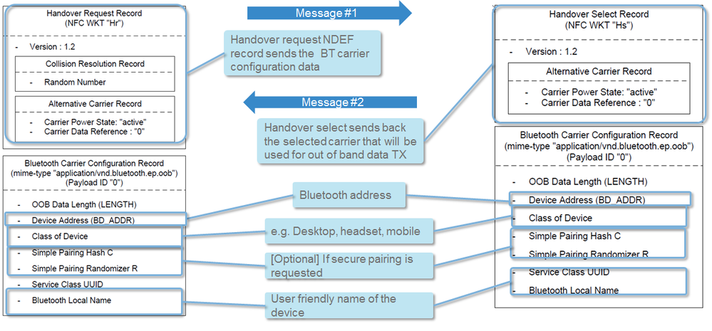

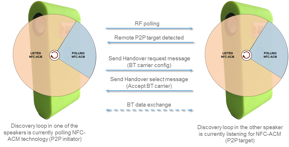

NFC pairing: Negotiated handover
The other possibility is that when both speakers are tapped, they find themselves during the P2P operation. In such a situation, the pairing process will be conducted according to the Negotiated handover mechanism. One of them will take the role of initiator, the other the target role:
  • The initiator will poll for target devices
  • The target will respond to the initiator command
  • The initiator will send a handover request message, with the carrier details
  • The target will respond with a handover select message, indicating the selected carrier option.
On the received data, the initiator will establish a connection according to BT protocol. After that, both devices start streaming audio over BT.
In this case, both speakers exchange data with their alternative carrier capabilities, could be more than one.
  • The initiator communicates to the target device its carrier capabilities with a Handover request record followed by an NDEF record per each available carrier (in this case, just one BT carrier).
  • After that, the target replies to the initiator with the selected carrier to be used for the out of band data transfer.
As before, the BT configuration in the NDEF message includes fields such as: BT address, device class, BT local name, and optional data if secure pairing according to BT spec is required.The key here is that, this negotiation protocol and these message formats are specified and defined in the NFC Forum specs, so they offer an interoperable solution for any compliant-platform

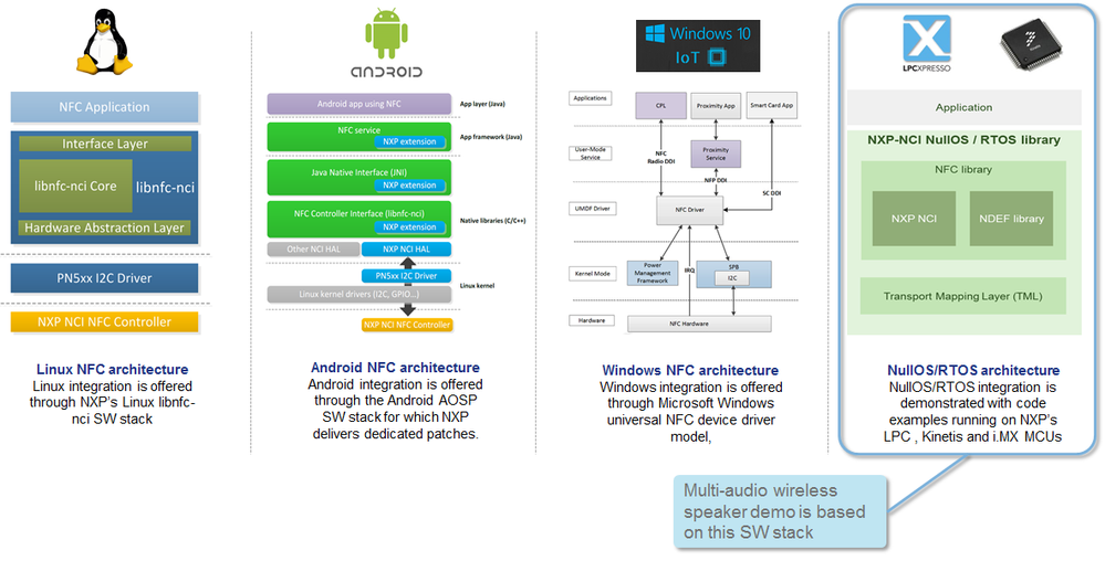

Software support
From a software support point of view,  device manufacturers can easily integrate PN71xx family in Linux, Android and Win IoT systems through the available SW drivers. But also, NXP supplies a set of code examples running on LPC and Kinetis MCUs for Bare metal RTOS integration.
Precisely, the demo presented in this post, leverages on the NullOS/RTOS SW examples. The software example for PN71xx integration into RTOS / Bare metal system is made of 3 components:
  • The NXP-NCI module offers an API for configuring, starting and processing the NFC device discovery
  • The NDEF library offers an API for processing NDEF data over reader, card and p2p modes:
  • The transport mapping layer providing HW abstraction for the host – NFC controller connection
On top of it, developers can implement their own application.
