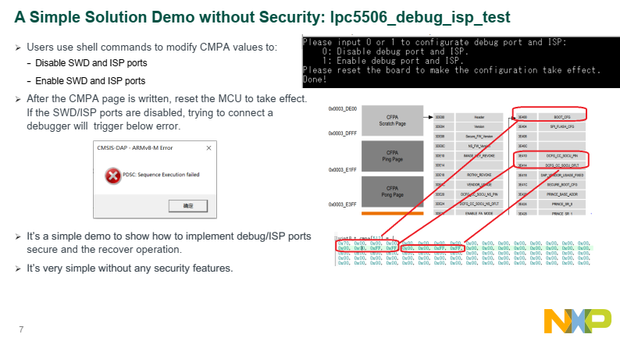

  1. lpc5506_debug_isp_test_20220714: demonstrate how to operate this region to lock Debug Port then how to recovery it. The user interaction could be raised by UART or button;

This is a complete solution to secure & recovery debugging/ISP ports on LPC55, and it uses
host machine challenge mechanism to implement security features:
Challenge Host machine against unknown host probe;
Generates dynamic seeds, so that the final encrypt information will be dynamically changed;
The image hash value is device related, that avoids same encrypt info for different image/product;
