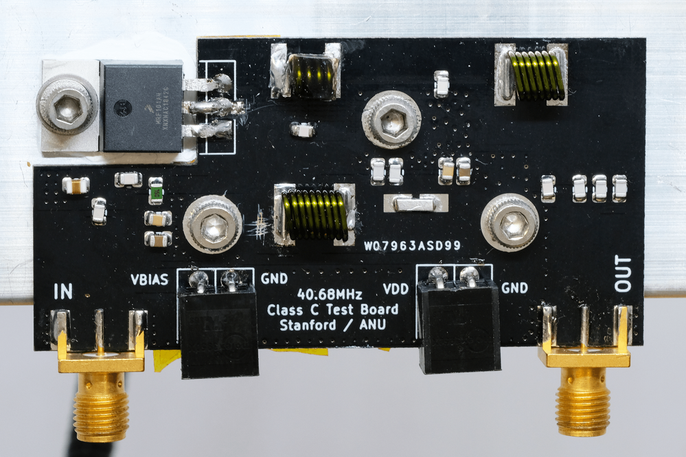

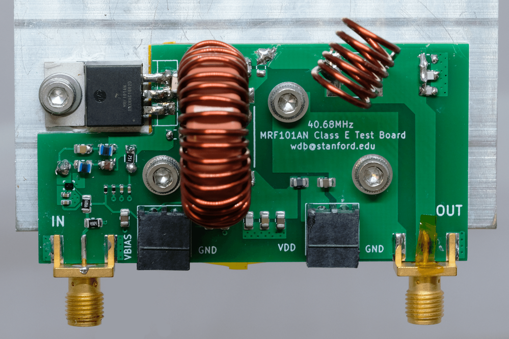

A High Efficiency Switchmode RF Amplifier using a MRF101AN LDMOS Device for a CubeSat Plasma Thruster (For more information visit: Research - SuperLab@Stanford )
The Class E amplifier utilizes the active device as a switch, operating in only cutoff (off) and saturated (on) conditions. This minimizes the overlap of voltage and current, reducing losses in the active device. To further reduce loss the Class E amplifier utilizes an inductively tuned resonant network to achieve zero voltage switching, bringing the voltage across the switch to zero before turn on, eliminating energy stored in the output capacitance of the active device that would otherwise be dissipated. This is achieved with an inductively tuned series resonant output filter.
In the Class E amplifier losses are almost entirely determined by the current conducted by the active device so a high drain impedance is desired to maximize efficiency. The drain impedance is ultimately limited by the voltage rating of the switch. For our desired output power of 40W and the maximum voltage rating of 133V for the MRF101AN this impedance is still less than 50 ohms, so a L match circuit is used to match the drain impedance to 50 ohms. The load network in our design provides a drain impedance of 15.4+12.8j.
As the MRF101AN will operate in saturation a high drive level is desired. To eliminate the need for a preamplifier and allow for digital control, we use a high speed gate drive chip typically used in switch-mode power supplies, LMG1020, to drive the MRF101AN instead of a RF preamplifier. A resonant network is used to provide voltage gain at the fundamental and third harmonic, providing a quasi-square wave on the gate which helps insure the device remains in saturation.
