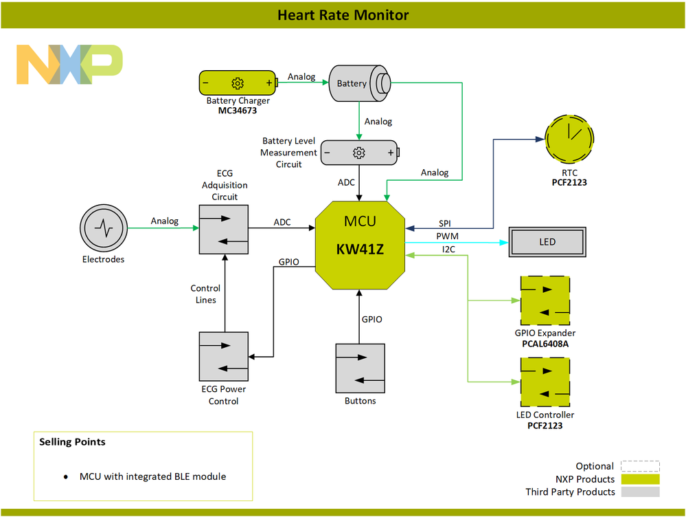

Description
This heart rate monitor is based on NXP’s KW41Z, an ultra-low-power BLE-enabled MCU that provides all the capabilities for acquiring, processing and sending data obtained from analog sensors. NXP also offers a battery charger IC, RTC and LED controller for a complete heart rate monitor solution.
Block Diagram
