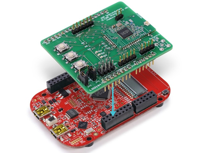

The OM2385/SF001 is a development platform dedicated to SIGFOX Wide Area Networking applications. It includes an OL2385 wireless sub-GHz transceiver running the preprogrammed SIGFOX library and is mounted on an FRDM-KL43Z development platform that serves as a host processor for the user's application.
The FRDM-KL43Z is an ultra-low-cost development platform for Kinetis L families KL43, KL33, KL27, KL17, and KL13 MCUs built on Arm Cortex-M0+ processor running at 48 MHz.

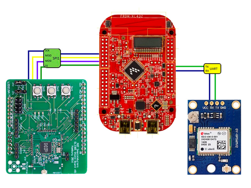

Hardware Diagram:
SPI OL2585
KL43Z FRDM
UART GPS
MOSI ----------
MISO ----------
SCK -----------
ACK -----------
CS -------------
PTD07
PTD06
PTD05
PTD02
PTD04
PTE23
PTE22
----------- TX
----------- RX
This picture shows the board connections made for the project

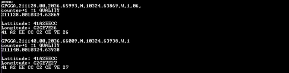

  9. Teraterm console prints the data obtained from the GPS module for your viewing purposes.

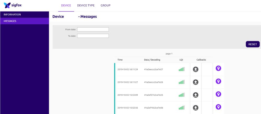

This is the data sent from the Sigfox transceiver to the user backend account. The sent frames are floating-point coordinates converted to four byte-hexadecimal strings.
After the attached project is flashed to the KL43Z, this should be the results seen in the Teraterm console.
