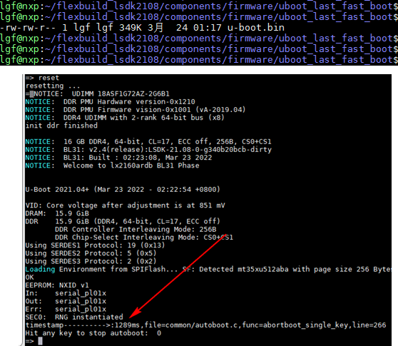

Objective
To speed ​​​​up bringup of LX2 chip-based systems
Pain Points to Address
The bringup time is much longer than 3s, which is very sensitive in ADAS systems or time-sensitive systems.
Value Proposition / Key Features
The guide can help customers shorten uboot time from 5s to less than 1.5s, saving more than 70% bootup time.
Deliverables
Demo based on LX2160ARDB board.
Reference codes and patches.
Guide for Fast boot document.

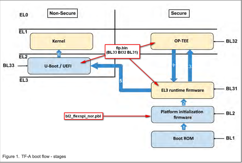

Fast boot 广泛用于嵌入式设备,现以lx2160ardb板为例进行相关探索。
启动流程:
优化思路:

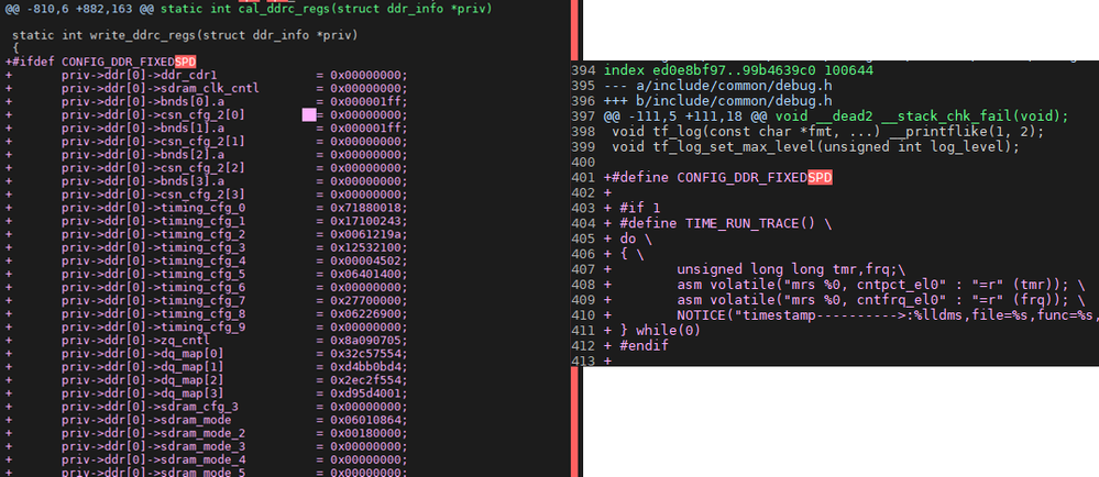

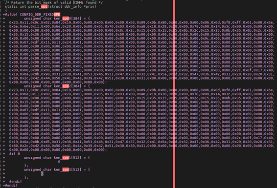

2.关键路径优化
  1. 固化spd参数
  2. 固化ddrc参数
  3. BL33 裁剪
详细patch和测试结果参考附件。
