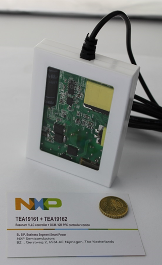

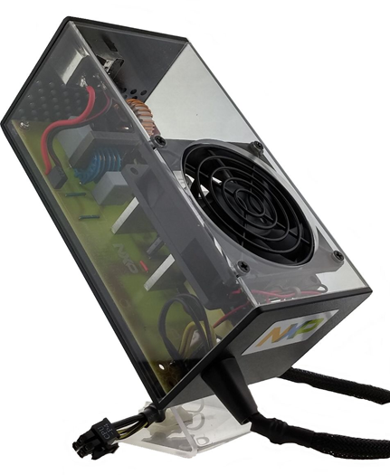

Desktop PC Supply. 12v, 20A (240W)                                                   Ultra Slim 90W Adaptor. 19.5V / 4.6A (90W)

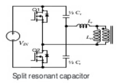

For TEA19161T, from datasheet I cannot see HB split-cap.
Is it possible to use this controller for topology half bridge split-cap? (pic below)
