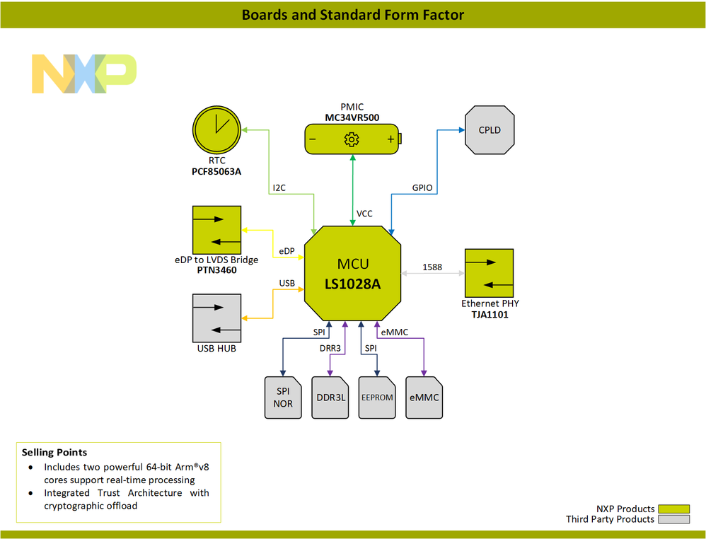

Block Diagram
Block-Diagram-Boards-and-Standard-Form-Factor-PNG.pngBlock-Diagram-Boards-and-Standard-Form-Factor-PNG.png
Product
Category MPU
Product URL Layerscape® 1028A Industrial Applications Processor
Product Description The Layerscape LS1028A industrial applications processor includes a TSN-enabled Ethernet switch and Ethernet controllers to support converged IT and OT networks.
Category RTC
Product URL PCF85063A: Tiny Real-Time Clock/calendar with alarm function and I2C-bus
Product Description The PCF85063ATL is a CMOS Real-Time Clock (RTC) and calendar optimized for low power consumption. An offset register allows fine-tuning of the clock.
Category Power Management
Product URL MC34VR500: Multi-Output DC/DC Regulator
Product Description The NXP® MC34VR500 power management solution for network processor systems is a high-efficiency, quad buck regulator with up to 4.5 A output and five user-programmable LDOs.
Category Transceiver
Product URL TJA1101: 2nd generation Ethernet PHY Transceivers - IEEE 100BASE-T1 compliant
Product Description
TJA1101 is a high-performance single port, IEEE 100BASE-T1 compliant Ethernet PHY Transceiver.
Category Display Port
Product URL PTN3460/PTN3460I - Commercial and Industrial e(DP) to LVDS bridge IC
Product Description PTN3460 is an (embedded) DisplayPort to LVDS bridge device that enables connectivity between an (embedded) DisplayPort (eDP) source and LVDS display panel.
