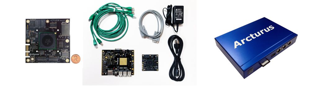

uCP1020 - Gateway Module (80x80mm)  |  uCP1020 - Development Kit  |  uCP1020 - Module and Host-board in optional anodized aluminum enclosure

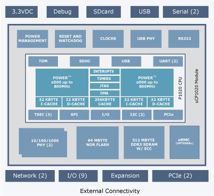

Product Diagram(s)
IoT Physical Components
Gateways
Edge Devices
