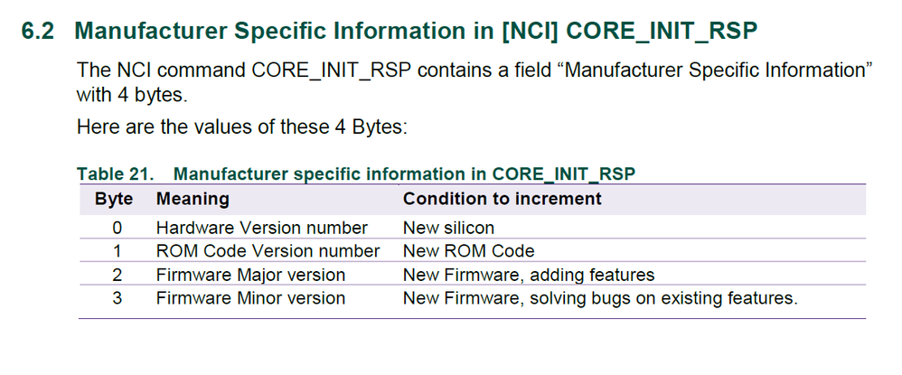

Kan_Li
Hi Norman,
Thanks for the information! Would you please help to check the Manufacturer Specific Information in [NCI] CORE_INIT_RSP on your side? We may have the firmware version info from this. Please kindly refer to the following for details.
Thanks for your patience!
Kan

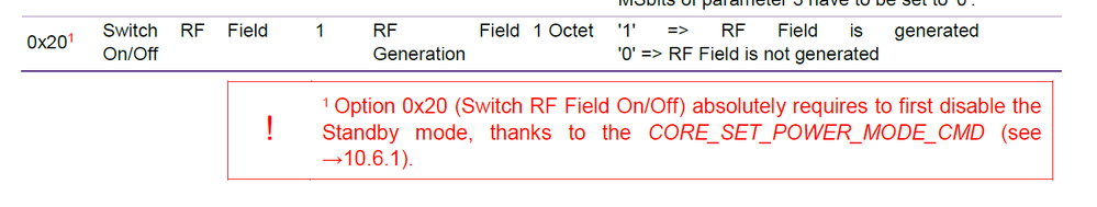

Kan_Li
Hi Vicente,
Did you set PN7150 in the correct state? Please refer to the following for details.
Kan

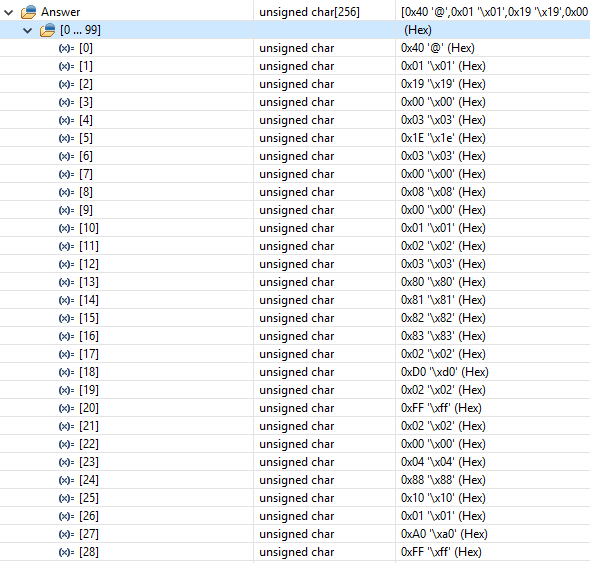

normbxl
Hello Kan,
here is a screenshot of the full 28 bytes of the CORE_INIT_RSP:
HW_Version= 64
ROM version=1
FW version = 25.0
