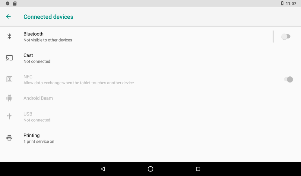

Hi I.MX community
excuse me, recently I try to integrate nfc chip into system, below are some system information
OS: Android 8.0.0_1.0.0
Mother Board: i.mx6q sabresd board
chip: pn548(npc300)
above is our integrate information, and i use NFC_NCIHALx_AR00C0.8.4.0_OpnSrc integrate into our i.mx6q board
here is the source code web NXPNFCProject · GitHub
I already finished porting processing, and boot into system, but one of strange question confuse me, I am not sure whether below error cause nfc not work successfully.
1 . after open HAL , then system want to get nfc chip name, it will go NxpNfcCapability.cpp, then get 0x?? to get chip name , but i don't know why get 0x68, then choose PN80T, i am not use this chip, i use pn548, does anyone have good experience and suggestion, just feedback me

08-05 00:03:43.542 295 1093 D NxpNciR : len = 28 <= 40011900031E030008000102038081828302D002FF02000468100122
08-05 00:03:43.542 295 1096 D NxpHal : read successful status = 0x0
08-05 00:03:43.542 295 1096 D NxpHal : CORE_INIT_RSP NCI1.0 received !
08-05 00:03:43.542 295 1096 D NxpHal : NxpNci> FW Version: 10.1.22
08-05 00:03:43.542 295 1096 D NxpHal : CORE_INIT_RSP 1 received !
08-05 00:03:43.542 295 1096 D : Victor NxpNfcCapability.cpp: processChipType....
08-05 00:03:43.550 295 1096 D : processChipType HwVersion : 0x68
08-05 00:03:43.550 295 1096 D : processChipType NxpNci > Product : PN80T
08-05 00:03:43.550 319 866 I OMXMaster: makeComponentInstance(OMX.google.vorbis.decoder) in [email protected] process
08-05 00:03:43.550 295 1096 D : VICTOR phNxpNciHal.c: NFC_GetFeatureList ()chipType = 8
08-05 00:03:43.550 295 295 D NxpHal : Response timer stopped
08-05 00:03:43.550 295 295 D NxpHal : Checking response
08-05 00:03:43.551 295 1093 D NxpTml : PN54X - Read requested.....
08-05 00:03:43.551 295 1093 D NxpTml : PN54X - Invoking I2C Read.....

8-05 00:03:43.578 929 1079 D NfcAdaptation: NfcAdaptation::HalIoctl arg=9
08-05 00:03:43.578 929 1079 D : phNxpNciHal_ioctl : enter - arg = 9
08-05 00:03:43.578 929 1079 D : VICTOR phNxpNciHal.c: in phNxpNciHal_ioctl, case HAL_NFC_IOCTL_FW_MW_VER_CHECK
08-05 00:03:43.578 929 1079 D : VICTOR phNxpNciHal.c: nfcFL.chipType 0x00, rom_version 0x00, fw_maj_ver 0x00
08-05 00:03:43.578 929 1079 D : VICTOR phNxpNciHal.c: fw_mw_ver_check is 255
08-05 00:03:43.578 929 1079 D NfcAdaptation: IoctlCallback Ioctl Type=9
08-05 00:03:43.578 929 1079 D NfcAdaptation: VICTOR NfcAdaptation.cpp: IoctlCallback READY memcpy.....start
08-05 00:03:43.578 929 1079 D NfcAdaptation: VICTOR NfcAdaptation.cpp: IoctlCallback READY memcpy.....end

I think you can add the 0x68 in NxpNfcCapability.cpp
case 0x68 :
      chipType = pn548C2;
      break;
4,859 Views
WeiWeiBo
Hi Jimmy
thanks for your reply first, these days , I find some information and modified some HAL code, add case 0x68 seem has not work.
I found log from nfc start that will pass 4 state, nfc_set_state 0->1, 1->2, 2->3, 3->4, then go to phNxpNciHal.c case  HAL_NFC_IOCTL_GET_CONFIG_INFO. i think above log process is normal, but have no ideal why the NFC in setting still can not "ON" normally as the photo.

4,859 Views
nagendrasarma
we do have similar issue , any update on this ?
4,859 Views
WeiWeiBo
