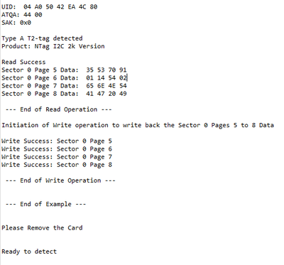

hello. I'm using the clev6630b  board as a reader to read from NTAG12C. I'm using example 9 from the NFC reader library. When I activate the passthrough mode, the data I read from the SRAM of the ntag does not change. How do I read new SRAM data continuously without removing the reader from the tag. Thank you

Hi  schakoma:
Could you please let me know what modifications you made on Ex9_NtagI2C demo. My test result for this demo is as below:
