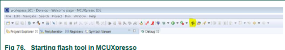

Mohamed_Alsabagh
hi@danielchen
i'm using nxp lpc link2 debugger to flash code using MCUXpresso but if i remove debugger the application on board stop and don't run again also stop if i press reset
why?
5,384 Views
danielchen
Generally, if you press reset, the application not run, it is likely application not programmed into flash.
If you need to programmed the app to flash, I would suggest you  refer to UM10883,  section 8.9 updating flash via SWD interface.
Click icon on the menu bar to start LinkServer GUI Flash programmer tool.
