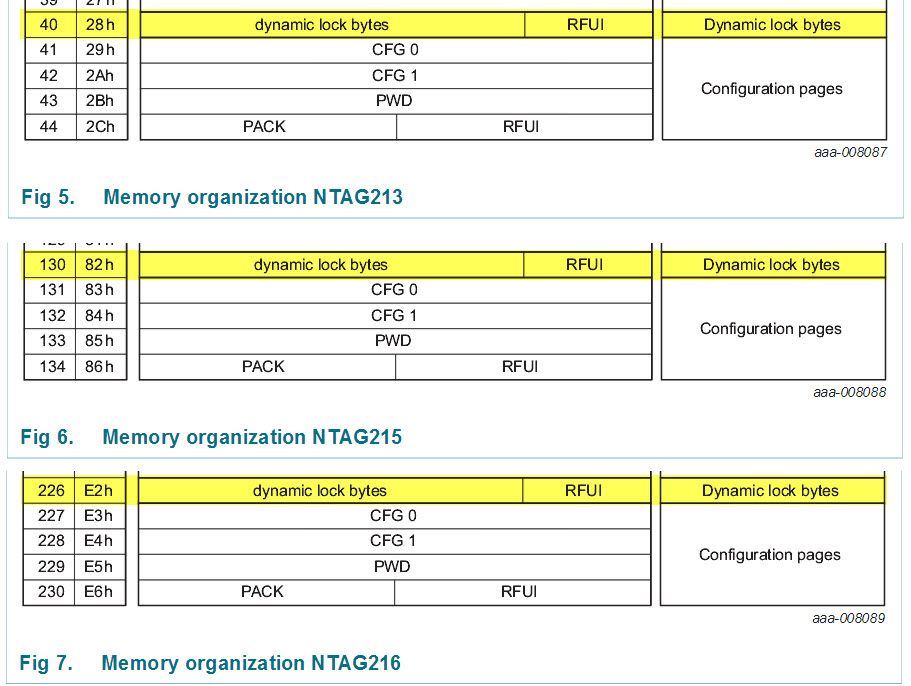

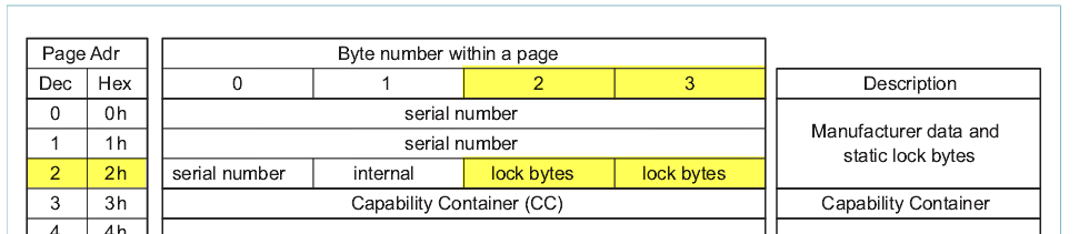

The setting of the dynamic lock bytes is also irreversible, so you can set the bits to 1 but not back to 0. The difference between "static" and "dynamic" is the position in memory for such bits:
- Static lock bytes are always the bytes 2 and 3 in page 2 of the NTAG memory:
- Dynamic lock bytes can be at different positions in memory. For example for NTAG213/215/216 you find the dynamic lock bytes at pages 40/130/226:
This naming is based on the NFC Forum Type 2 Tag Technical Specification.
