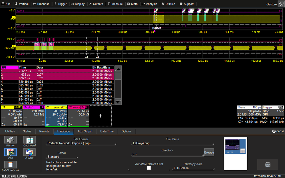

smiwa
Hi Christian san,
Please find the attached for the oscilloscope&Logic analyzer waveform. This figure is at the timing of WUPA command send (0x09+0x07+0x52 as SPI data). (triggered by "09" bit pattern)
RF field is already on before this command. After this command, ASK for "0x52" is expected but actually I got the some intermittent emission.
So, could you help me to check the possible causes for further  investigation as I think if I solve this issue I can get communicate to cards.
Thank you for your help!!
   S. Miwa

christianeisend
Do you see only the RF field on the oscilloscope or also modulation of REQA?
REQA modulation is usually quite easy to detect since Type A communication performs 100% ASK modulation - you should see 7 short (2-3us) RF off pulses. In case PN5180 doesn't send REQA, it will not be receiving ATQA of course.
ATQA is also visible on oscilloscope, but you need to reduce the contrast of the scope to see it. an ATQA usually follows 86us after the REQA.
Can you please check and confirm if you see both, REQA and ATQA using oscilloscope?
