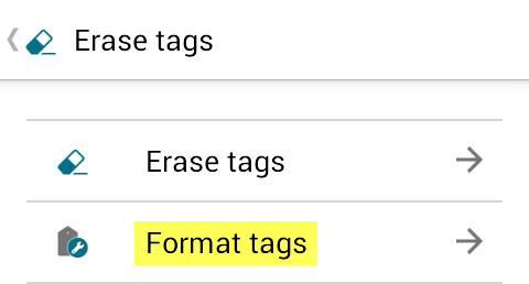

TagWriter: When I erase a Type 2 tag such as NTAG216 and attempt to use TagWriter to rewrite to the tag the TagWriter claims the tag type is not supported and will not rewrite.

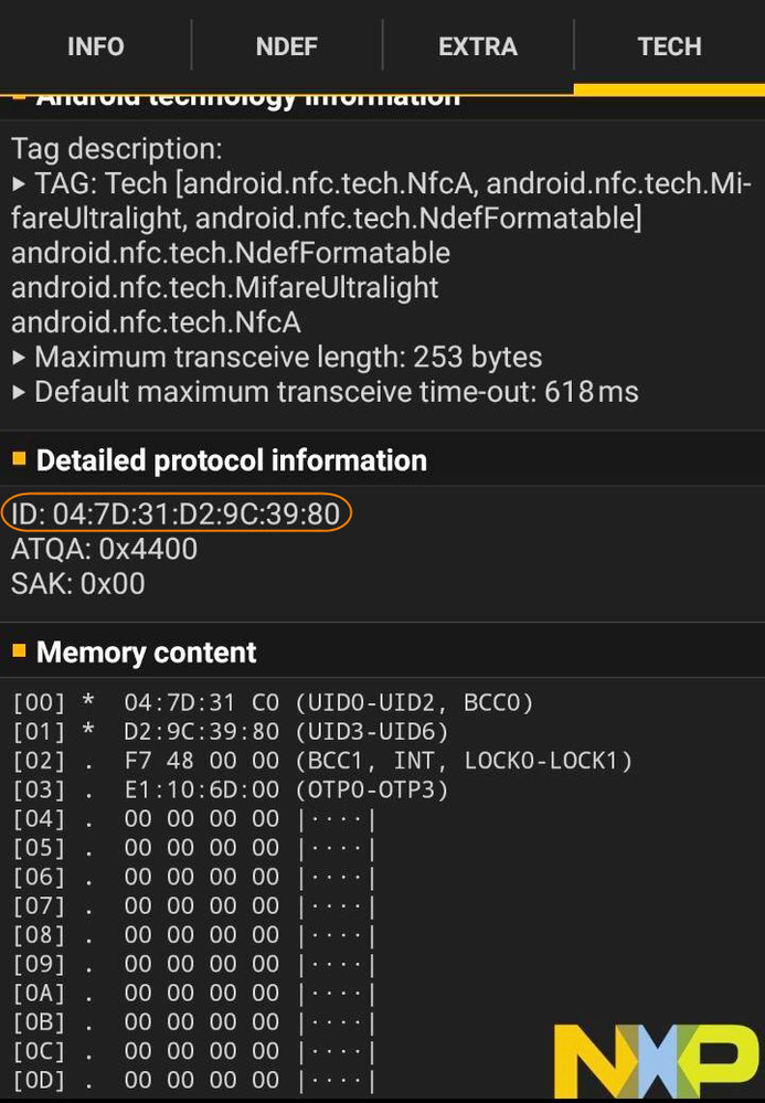

TagInfo: please explain where a tag's unique serial number is reported.
I am developing a WWW SaaS and interested in discussion regarding how to identify a tag to the web server. I have considered generating a GUID and appending with Query String written to the tag but if each tag has a unique serial number can I capture that serial number using TagWriter with TagInfo? Capturing and reusing a tag's serial number is likely a more reliable way to ID the specific tag for storing ID in a database and using that ID as a permanent record for the tag.

1) You may need to format the tag after it is erased. The option is in the same Erase tags menu:
2) The tag UID is reported under the Tech tab in the application. See below an example:
