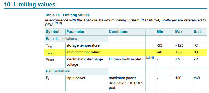

□UCODE8/8m datasheet 【10.Limiting Value】29page
Q:
I could not confirm the parameter of "Operating temperature” for UCODE8/8m.
Is "Operating temperature" same as "Ambient temperature"?
Please let me know the parameter of "Operating temperature" for UCODE8/8m.
Best Regards, Koshiro (SAXIS)

Hi Koshiro Yanai,
Hope you are doing great,  the ambien and operation temperature are not the same, the ambien temperature is the temperature of the air around the IC and the operating temperature is the temperature of the IC itself.  hope this small answer help you to understand the difference, if you have any question let me know.

I cannot confirm operation temperature of UCODE8/8m from datasheet.
Acutually, What parameter is operation temperature of UCODE8/8m?
BR, Koshiro
3,707 Views
Jonathan_Iglesias
in the datasheet, https://www.nxp.com/docs/en/data-sheet/SL3S1205-15-DS.pdf
in page 2 can be found a reference to the operation temperature,
and in page 29 the  ambient
maybe I am not understanding correctly your question please let me know.
Have a nice day !
Jonathan
