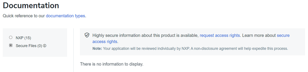

[AN12343] corresponds to MIFARE DESFire Light products. For MIFARE DESFire EV3, as some of the information is secured under NDA (Non-Disclosure Agreement), and therefor this information is not public, please consult the Non-Disclosure Agreement FAQs. You can try requesting an NDA directly from the NDA online form; after your request is processed, you should be contacted by the NXP NDA team.
Once you have a valid NDA with NXP you would need to request access to the documentation through Secure Access Rights.
For this, you could follow the instructions from this page: Secure Access Rights | NXP Semiconductors. Also, I would recommend checking the Secure Access Rights FAQs | NXP Semiconductors.
