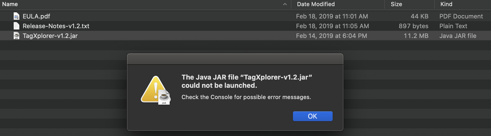

Hey!
I can't get TagXplorer-v1.2.jar to run.
I tried Oracle Java 8.221; i tried Zulu Java.
When i doubleclick it doesn't start.
When i use command line, i get the following error:
"Fehler: Hauptklasse TagXplorer-v1.2.jar konnte nicht gefunden oder geladen werden"
I use Win10.
Any ideas ? :smileysad:

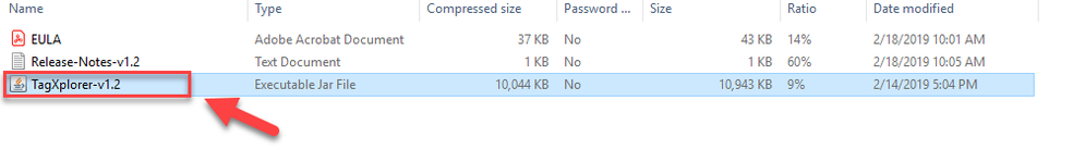

IvanRuiz
After downloading the zipped folder from following link: https://www.nxp.com/downloads/en/apps/SW4883.zip
You should run the .jar as shown below:
It is running ok for me, otherwise please try on another computer.
BR,
Ivan.
