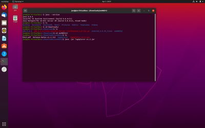

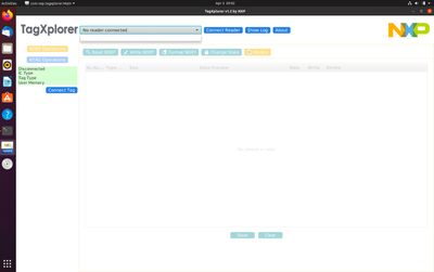

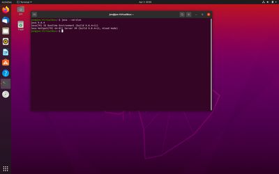

I've now tried this on Ubuntu 20.04 and get much the same result. The steps I took were:
  • Install Ubuntu on Virtualbox
  • Install the drivers for the uTrust 3700 F, following the setup guide
  • Install Oracle Java 9 since that includes JavaFx - Check the version
  • Boot the machine -  check that the card reader is connected (see screenshot) using pcsc_scan
  • Run TagXplorer - Result is no reader connected as on MacOS
Does anyone in this thread have any other thoughts on this. I would really appreciate any advice. I'm also attached the output when running the jar.
