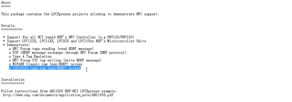

We got PN7120 Kit and port libnfc-nci to Raspberry-pi.
And, we have to read data from ISO15693 card.
But, I am not sure libnfc-nic can support ISO15693.
Demoapp seems not to have ISO15693 procedure. Am I right?
I don't know about NFC. I just want to read 15693 card.
What is best idea?

Hi Paul,
Yes, libnfc-nic can support ISO15693.You may refer to NFC_Reader_Library\NxpNfcRdLib\comps\phpalSli15693 for details. and LPC based demo can be downloaded from http://cache.nxp.com/documents/software/SW3241.zip . Please kindly refer to the following for more details.
Wish it helps.
