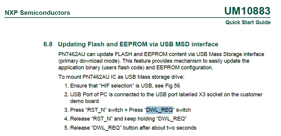

Hello All,
I need have possibility to upgrade firmware. I read at Quick Start Customer Board about primary downloader. It can be run if I press "DWL_REQ" during reset IC. (I didn't find any other information except how to disabled it permanently)
It is possible to start / request primary downloader from user app/code? It will pass my requirements

Hi Kamil,
I am sorry, but so it is not possible to do what you expected, as the ROM boot loader has the activities fixed.

benten
Hi Kan,
My requirements are not describe how to achieve this.
In my opinion - optimal way it will be "jump to bootloader" without rebooting. Our user app implement CCID protocol. I want to send "escape frame" with "jump to bootloader" command . IC should disconnect CCID usb staff and switch to USB mass storage.

Kan_Li
Hi Kamil,
It is possible to jump to bootloader without rebooting, but it still has to check the state of DWL_REQ pin, please refer to the following for details.
maybe you need an external circuit for help with this action.

benten
Hi Kan,
I read this instruction some time ago - but it suggested that: external cirtcut need set dwl_req to HIGH/LOW and reset the PN7462. So I asked it is possible to do without IC (from user app, not external circuit).

benten
Hi Kan,
I created secondary bootloader...

benten
Dear Shiv,
I write bootloader (with limited memory) which:
a) handle all interrups form NXP (register them in VECTOR_TABLE_NAME)
b) redirect it to main program, for example (i had to compute address of IRQ/Vector table of main program, for example):
void RF_IRQHandler(void)
	/* Re-direct interrupt, get handler address from application vector table */
	asm volatile("ldr r0, =0x207048");
	asm volatile("ldr r0, [r0]");
	asm volatile("mov pc, r0");
c) in main jump to main program:
if(is_in_app){
		/* Load main stack pointer with application stack pointer initial value,
		   stored at first location of application area */
		asm volatile("ldr r0, =0x207000");
		asm volatile("mov sp, r0");
		/* Load program counter with application reset vector address, located at
		   second word of application area. */
		asm volatile("ldr r0, =0x207004");
